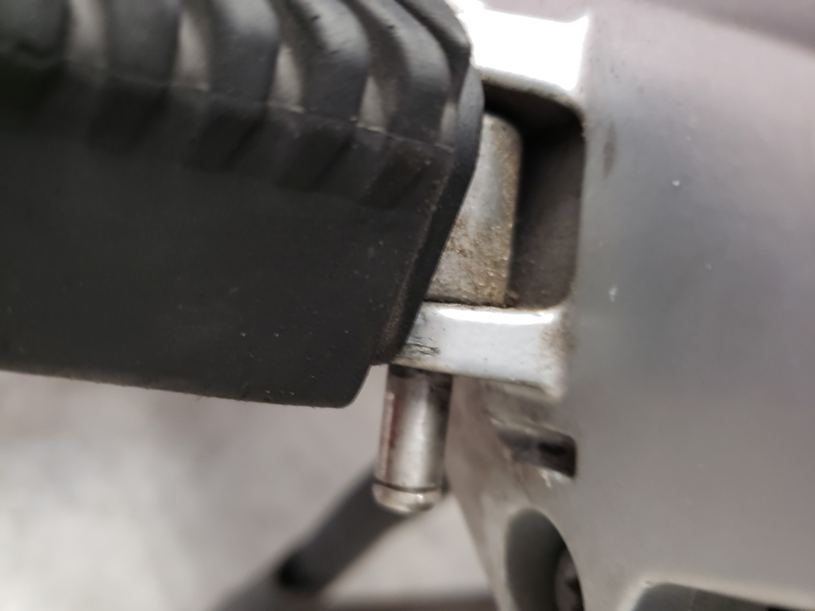

Hi forum,
New to this forum, just acquired 2013 1200RT. I purchased lowered footpegs, and when attempting to remove the old ones, I found the main pivot pin would not budge. I removed the circlips and spring and insert that goes inside of spring. The pivot pin could not be moved at all. Not sure if there is some trick, or if it's just really stuck. Attempted to gently hammer it up and out, doesn't budge. I cannot rotate the pin inside of the footpeg either. Any thoughts or tips would be greatly appreciated. I've added bike pic just because we all want to see the ride. Well, most of us anyway.
seems like photo's are sideways, I'll need to sort that out for the future. For now it will have to do.
Thanks!

Perhaps the problem is corrosion between two dissimilar metals. Probably a steel pin in an alloy footrest. How about removing the footrest plate, turning it upside down and applying some penetrating oil. If the footrest rubber is removed, some gentle heat may help too. Plus, the pin would then be driven down not up.

I had the same issue when I fitted lowering pegs on my 16.The only way I could get it out was to put the hanger in a vice,support the back with some wood,spray some lubrication on it and knock it out with a drift.I tried to do it gently but gave it a big hit in the end and it then slid out.Upper most in my mind was cracking the hanger so I made sure it was well supported.

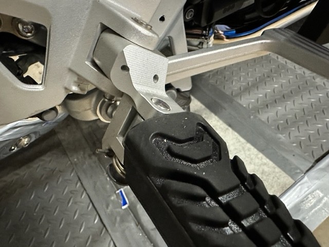

If the lowering kit is the Wunderlich or typical Ali Express type then it consists of an additional cast block that is held in place by the original pivot pin, and the new casting has a new pivot pin.
Removing the new pivot pin should be straight forward and will release the peg and spring from the new casting. This is the pin shown in photo in original post and it does look in this case like corrosion
To remove the original pin that holds the new casting to the bike frame you have to first slacken off two grub screws that clamp the casting tightly against the frame to prevent rattling
You will see two small holes on the face of the casting and each has a grub screw. They are different sizes. One is 2 and the other 3mm Allen key size. If you don’t slacken these then the main pin will be jammed by this force.

Just to chuck my pennies worth in. I've just fitted some Far East copies of a well known German brand of footrest lowering kit, and exactly the same issues with my '18 R1250RT. The pins were seized solid. What really should have been a half an hour swap turned into 2hrs of cursing & swearing. Bi-Metalic corrosions is well document. Come on BMW for the money we pay you can do better.
