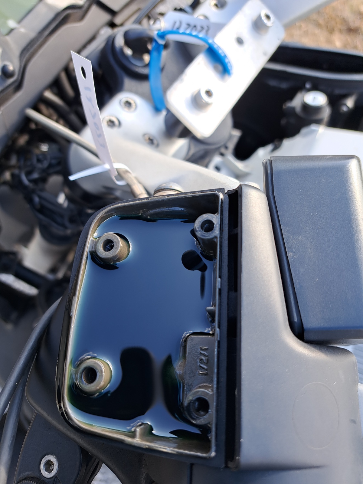

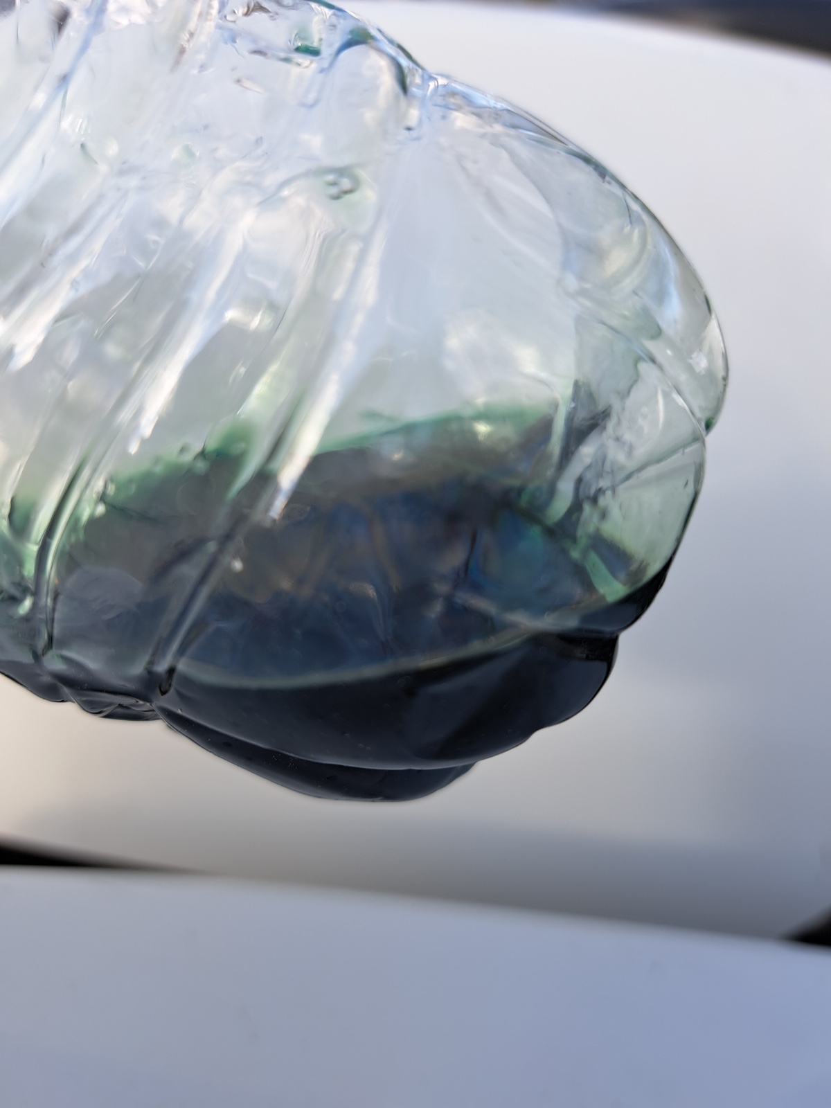

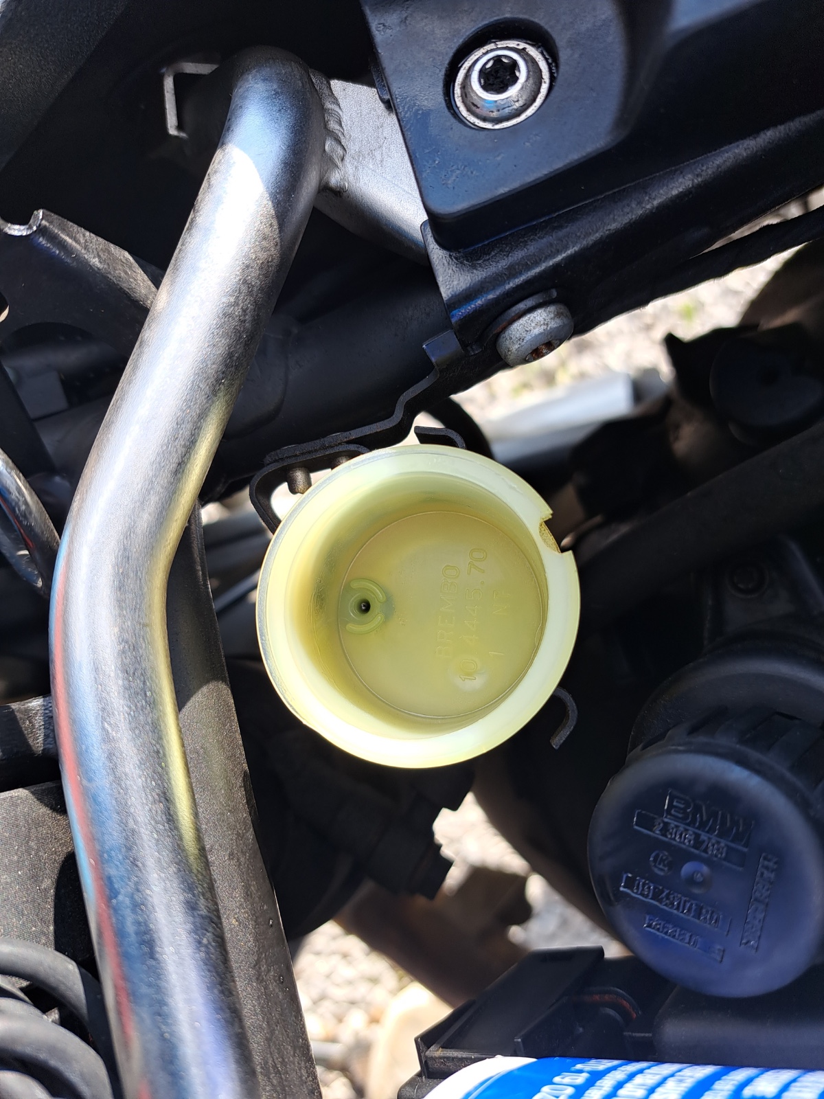

Here are a couple of pics, the reservoir was full but the fluid is pretty polluted, second pic of the fluid I extracted from the reservoir. I cleaned out the reservoir using a microfiber and got it pretty clean, there was a light coating of black film on the bottom of the reservoir. It wasn't completely black but I would give the quality of the fluid as poor.
I also flushed the brakes. There was fluid in the line in the rear brake but the reservoir was empty. Front was clean but the lever was mushy. I am guessing all of these fluids may have been in the bike since it was new. I didnt see any tool marks on either the brake or clutch reservoir.
