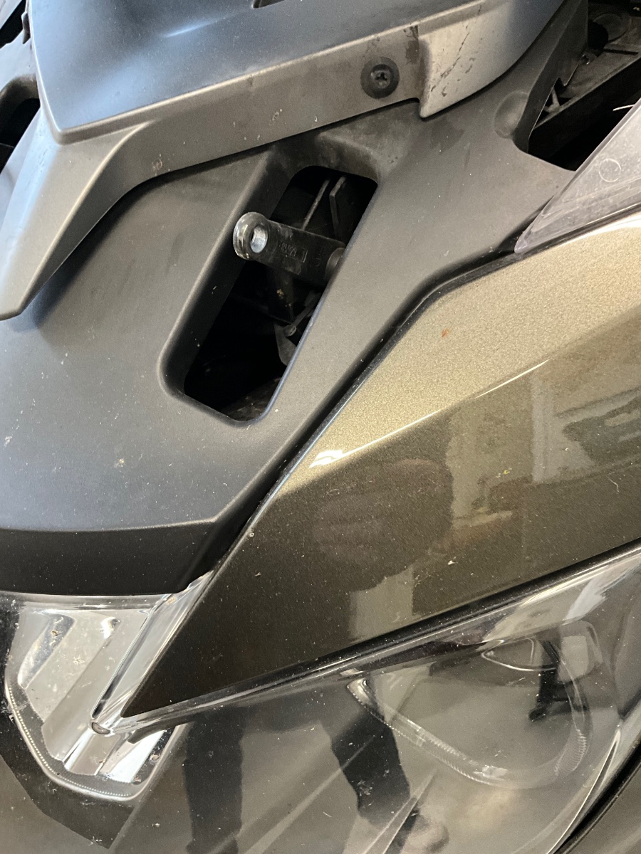

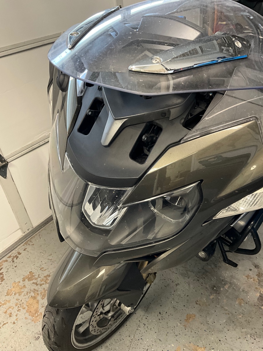

Riding down the road, minding my own business, and the windshield tipped back. Only 1/2 mile from home, so I finished my trek.
Get in the garage to find the two pins or bolts that hold the bottom of the windshield to the up/down frame are gone!
Now, I am on a mission to replace them. Local shop’s closed today. I found an on line microfiche, but the parts are not listed. Anyone help me?

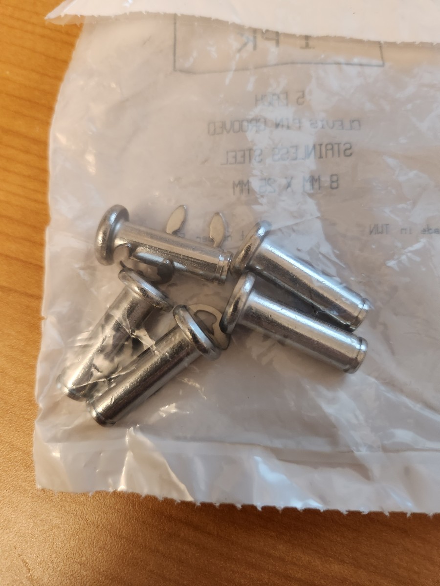

This is what works on my 21 RT. I can't remember where I got them, Amazon, Grainger, McMaster Carr, Fasenal, Lowes, etc..
- 20230530_060322.jpg (211.89 KiB) Viewed 2888 times
- 20230530_060311.jpg (148.43 KiB) Viewed 2888 times
