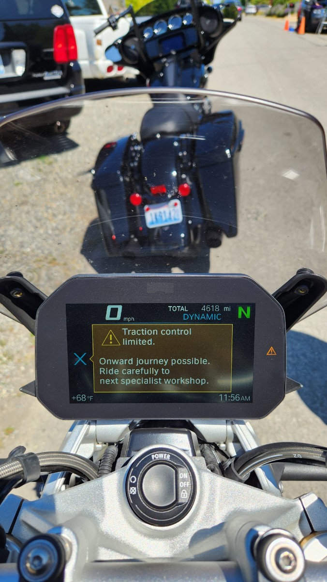

Started happening to my 2020 R1250R. Will start fine initially, ride about 30 min to my uncles. Cool 20 min Then when go to start get faulty lamp error or traction error. Use a portable jump start, it starts up no issues multiple times. But then keep happening. Took to dealer they could not replicate issue , checked codes and sent me on my way. It happened again. Dealership seem perplexed but this needs fixed. Plz more guidance?
- 20230701_115612.jpg (259.81 KiB) Viewed 3740 times
