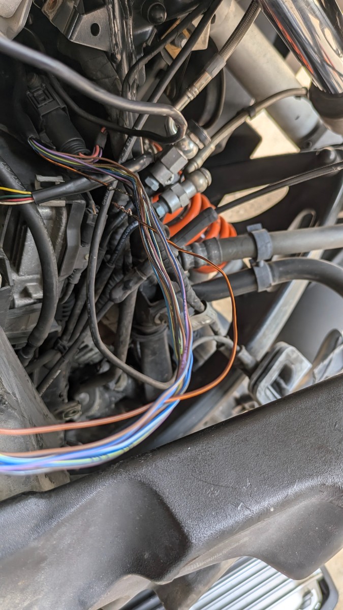

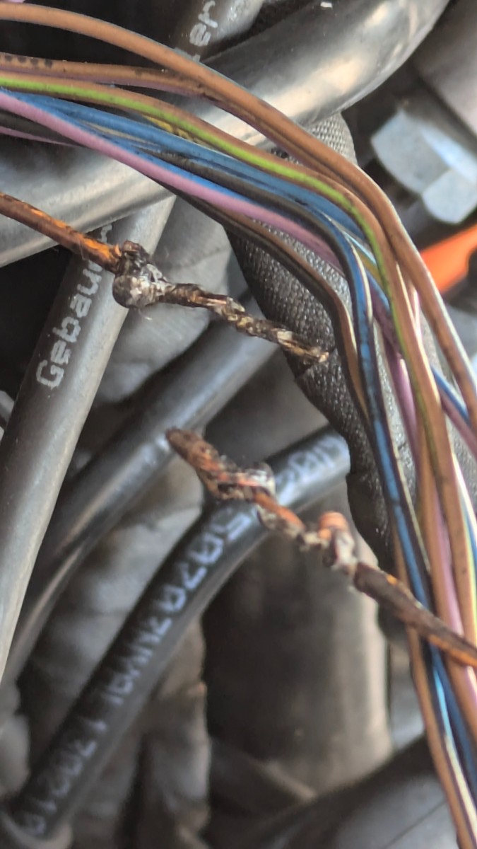

Re: R 1200 RT Engine cut of at stop and will not restart (starter does not turn)
Success!!
Following the wiring from the top of the triple-tree I found the bundle that would make and break the connection. I could enable or disable the initialization of the bike. I removed all of the wire ties and began to cut away the loom sheathing to expose the individual wires. There is was. An on-the-roadside-repair that was most likely supposed to be temporary until a better repair could be effected at home.
Well, it is done now.
Hope there are no more surprises coming up from other band-aid fixes!
Pics attached.
-Bill
Pics attached.
-Bill
This is incredible, but I’m confused at the images, did you bypass or repair the torn wire? Thank you!
I added in a section of similar gage wire since I had to eliminate the fouled soldered ends of both sides of the break. I slipped on a section of heat-shrink tubing, properly soldered the wire and heated up the heat shrink to conform. Since the loom had disintegrated when removed I wrapped the wires tightly in electrical tape. There is now enough wire that it does not pull on the are when turned from lock to lock. Hasn't missed a beat since.
