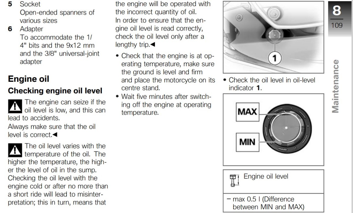

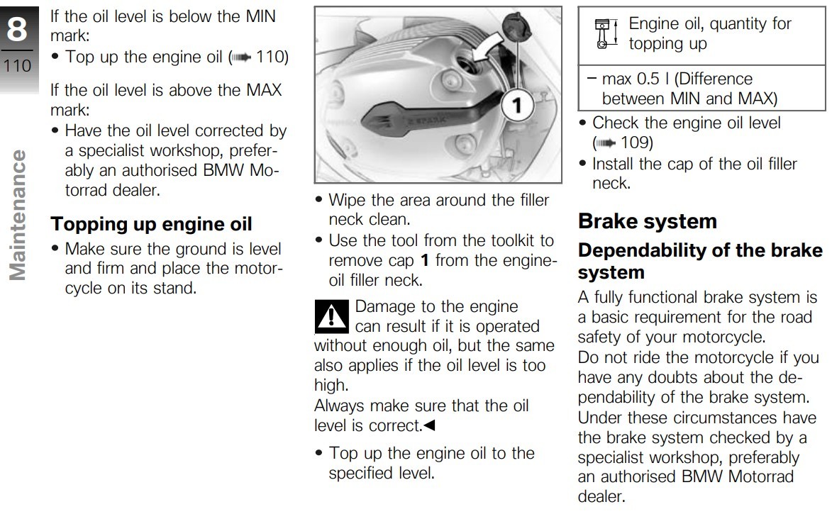

The Rider's Manual gives an engine oil capacity of max. 4.0 l, with filter change.
Page 109.jpg (179.44 KiB) Viewed 7493 times
Page 110.jpg (210.23 KiB) Viewed 7493 times

As your never going to get all the oil out, you always fill to the window,run the bike then check the window again.The amount of oil the engine holds as per the manual is from a dry point,not a bike that's had oil in and run/ridden.
I do the above(as the majority on this site do)then check again after a decent run.
Re: How much? (Not what brand)
I agree with the above, recently I supplied a BMW dealer with 4 l of oil and they only used ~3.5 l. The oil level was halfway between min & max.
