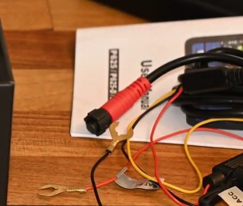

I haven’t received it yet but it seems it comes with a live and a negative connector as well as a yellow connector which I believe enables the unit to be switched on and off with the ignition switch.
Can any of you knowledgeable guys provide me with an idiot guide as to how to connect the unit power supply, preferably with photos.

Yes, sorted. There’s a blank connector left of yoke, bought a plug from flea bay, connected it to the Aoocci power leads, plugged in & works a treat.
I’ve put the link below to the YouTube video by Nothing To Prove which shows where the plug is.

I had a look and found that there was an old cable attached to that plug. I think the previous owner had a Garmin.
this lead had only 2 wires. ( the Aoocci has 3)
so I think I have worked out that there is a positive (red) negative (black) and the yellow one is the signal wire that turn the thing on and of with the ignition. but when I wired it up got nothing. only when I held the yellow to the red did did it fire up, but would not shot down when the ignition was turned off. I am hoping that I have a dodgy plug and have ordered another one.

As far as I remember, you don’t use the yellow wire.
