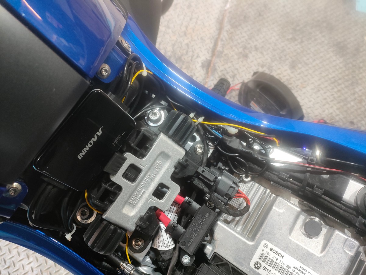

DVR between seat and tank 3M plastic velcro stuff holding it in place
innovv recorder.jpg (236.88 KiB) Viewed 1240 times

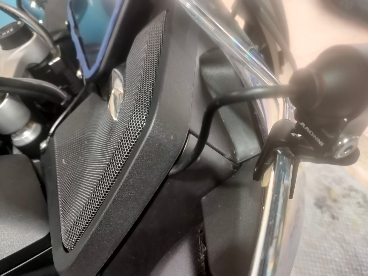

Front camera on the clear side panel using two L shaped brakets as a clamp
front camera.jpg (179.22 KiB) Viewed 1240 times

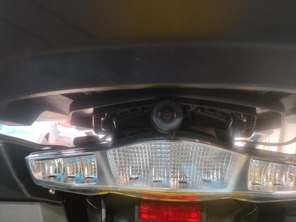

and rear Camera using zip ties under the rear carrier
rear camera.jpg (183.55 KiB) Viewed 1240 times
The GPS is on the side cover at the back under the grab handle and the control putton thing is on the fairing panel next to the AUx power socket
All of it can be removed without leaving a trace. Think Im using one of the camsmart circuits for the switched power but it could be from the rear Aux socket not 100%
