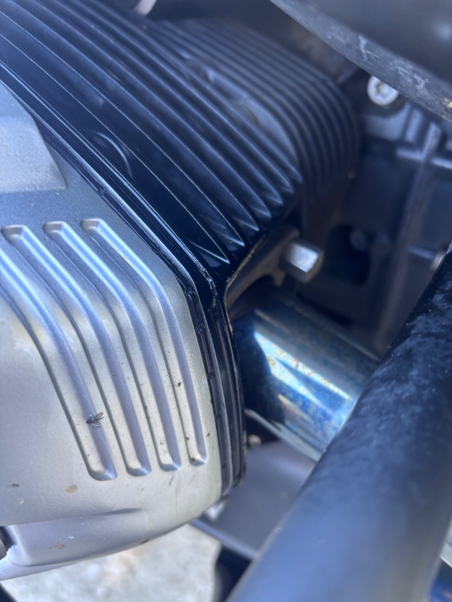

I’ve got a leak from right side valve cover. I’ve replaced the gasket with a new one. I believe previous owner replaced valve cover with aftermarket one since there isn’t a bmw part number on the inside. I’m out of ideas. Not sure what else to do.

I cleaned both surfaces thoroughly

Check for any "warpage" of the head cover. Aftermarket covers wont be up to OEM standards I would suggest, and could warp with the heating/cooling process.
Lay the cover on a piece of glass, (or a known flat surface) then use a feeler gauge to see if there is any difference between the glass and mating surface along its length.
This will hopefully indicate where the source of the leak is.
