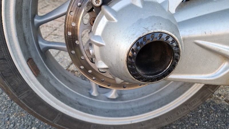

I recently bought a r1200rt. Year 2007. 34k miles. Navy blue.
Im pretty happy with it, but as we get to know each other i am uncovering the inevitable niggles. If you don't mind id like to get your thoughts so I can either fix it, hassle the bike shop, or contact a bmw dealer. 1st choice is always for me to fix it.
The biggest concern is there is a slight oil misting on the rear axle. Its not bad, but is it likely to get worse?
I like to think of myself as reasonably OK with DiY but from what I've read various special tools are needed to replace the seal. Its not dripping. No oil seems to be getting to the wheel or disk. What do you think?
At some point I'll drop the final drive to change the oil and inspect the universal joint. But there is no excessive play when in gear and on centre stand. No clonking. So im hoping it is fairly normal.

Lol... So I don't need to worry about the rear axle then..?

I am sorry, but I have almost nothing to add here. New BMW owner myself. I have seen videos on YouTube about rebuilding the final drive. That may help. Other than asking if there is some sort of breather in the housing I would suspect a leaking seal or o-ring.

Thank you for the yt video. This is exactly what I needed. I have ordered the outer seal, paste and oil. Fingers crossed I can sort this out soon. Much appreciated.
