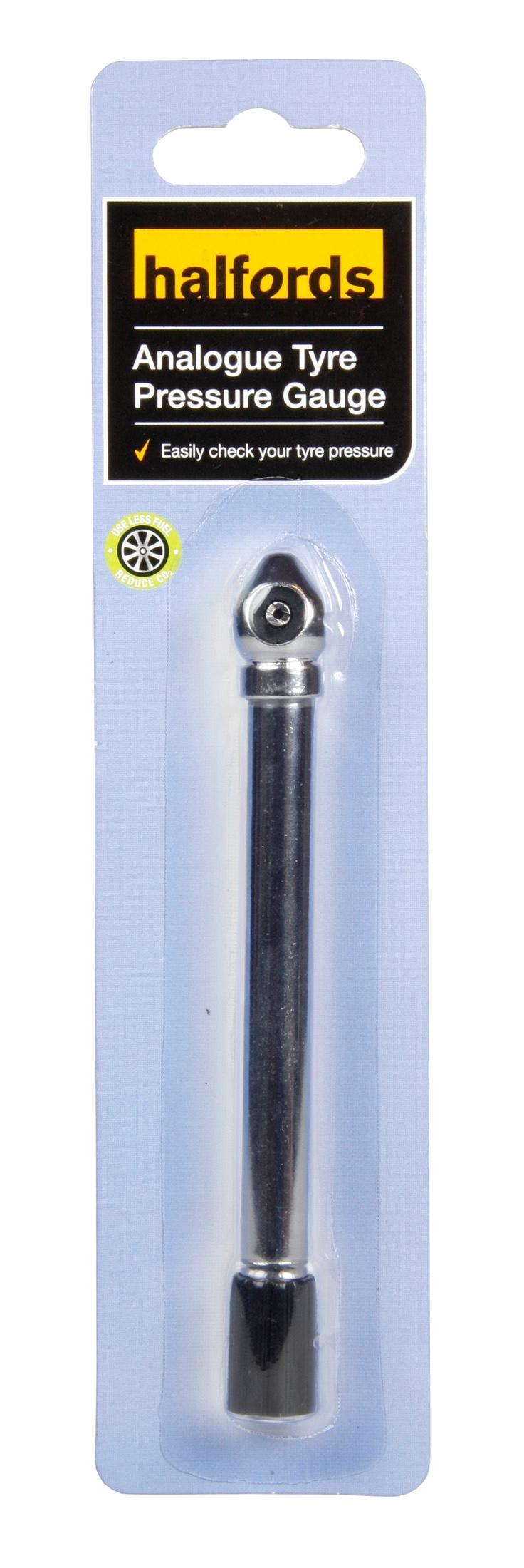

think I'll stick to my Halfords tyre pressure gauge £5.99, http://www.halfords.com/motoring-travel ... sure-gauge
