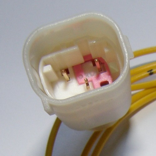

Do the connectors on the Nav V Cradle look like this.
J2 Pin 1 - GROUND
J2 Pin 2 - sense (Canbus, not needed)
J2 Pin3 - +12V
This is the Nippy Normans lead, looks the same as above.
Wires are numbered and need connecting as follows:
No 1 lead earth
No 2 Do not use
No 3 to red lead on sat nav

Don't think it's applicable in this case as he has the V cradle on.  However extremely useful for anyone else who wants to attach the Garmin cradle to any of the RTs.  I for one can never remember the cable numbers. Good find. Not sure if the adaptor cable isn't cheaper of purchased directly from a BMW dealer.
