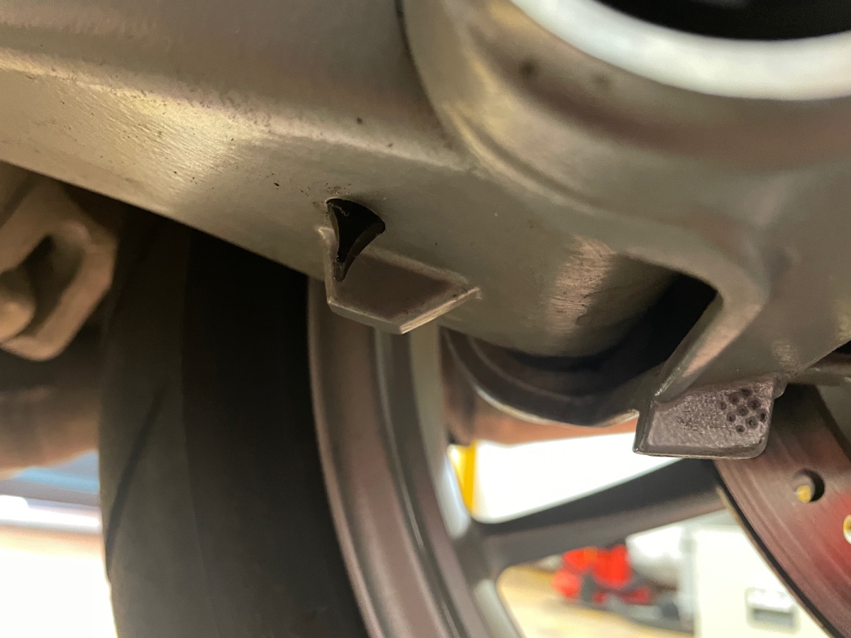

The shaft that failed on the fleet bike had no corrosion what so ever! The current fix is pretty rubbish, they drill a hole and put in a small rubber valve, that isn't glued in, so they are just being pushed back into the cardican casing. On one of our bikes that was done a week ago, it is missing already so needs replacing, but we will glue the next one in.

7vwh
Posts: 268
Location: East Yorkshire, UK
Has liked: 18 times
Been liked: 40 times
Re: Possible recall
Post by 7vwh »
This is the rubber bung on our RT-P (the image is upside down!)

Post by Casbar »
