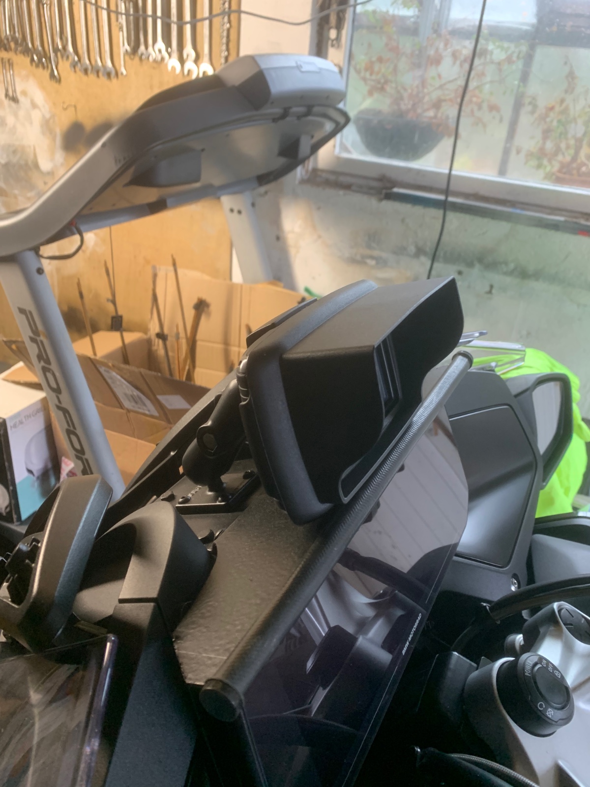

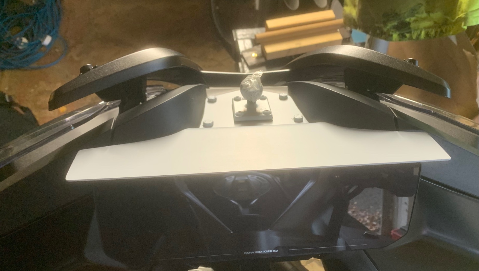

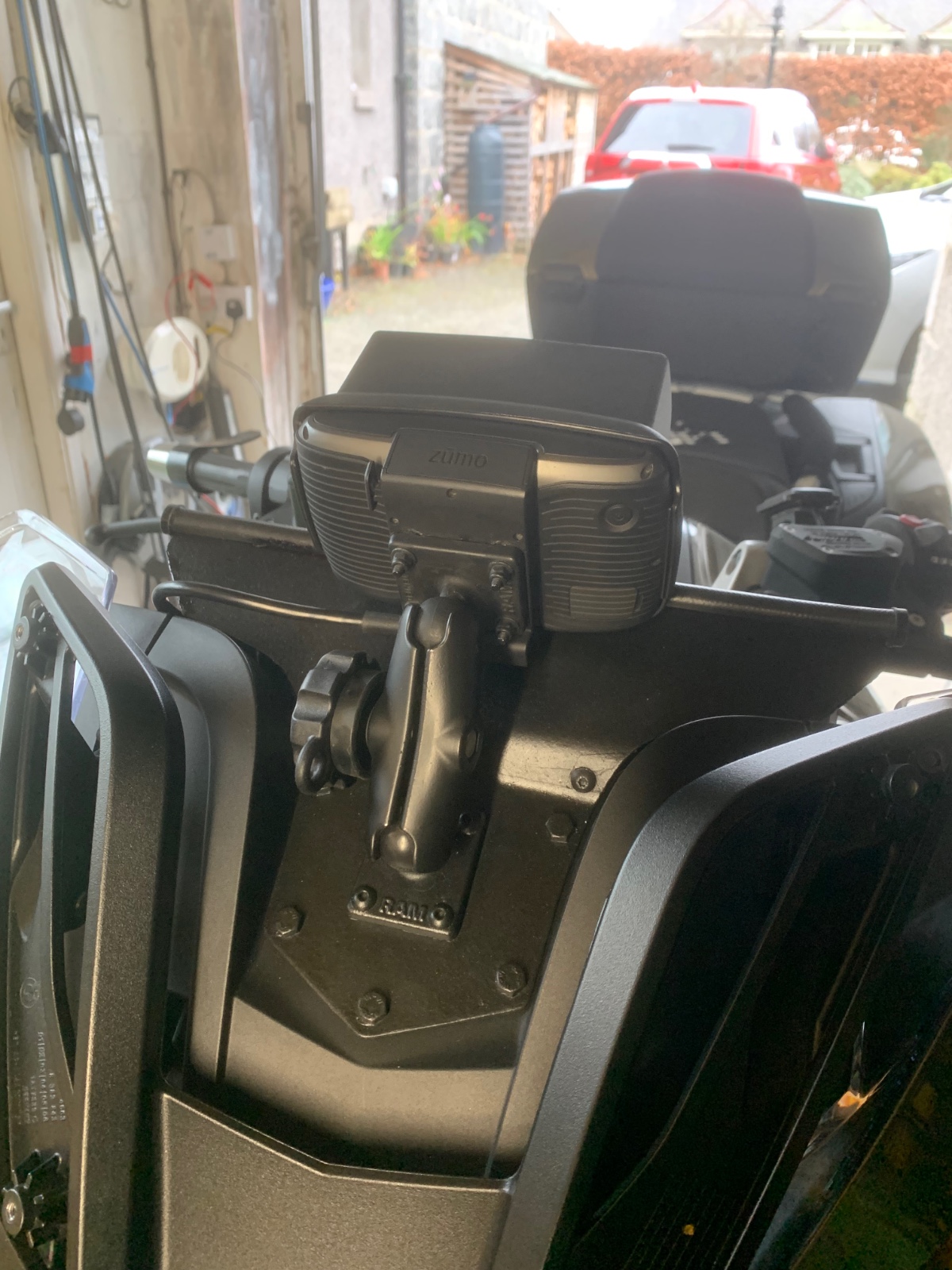

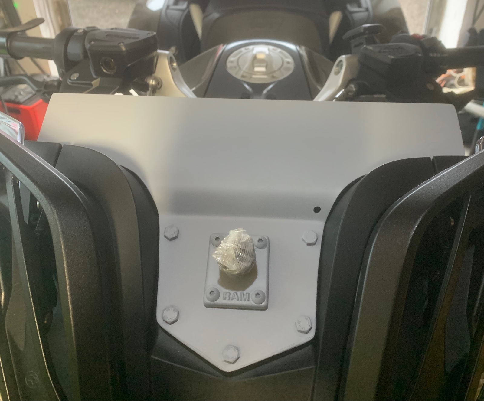

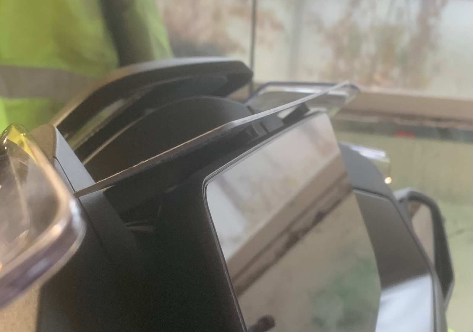

Here's the shield so far
Waiting for the top and bottom face woven copper sheets. Once they're bonded on and grounded through the ground strap it'll get a coat of stone chip then matt black for a pinseal like finish. After that it's just a case of bonding the flap under the ram mount to the panelwork, put the AV bumpers on, slip on the rear edge protector strip on and that's it!
Pleased so far.
Pleased so far.

Re: 2021 Nav system alternate.

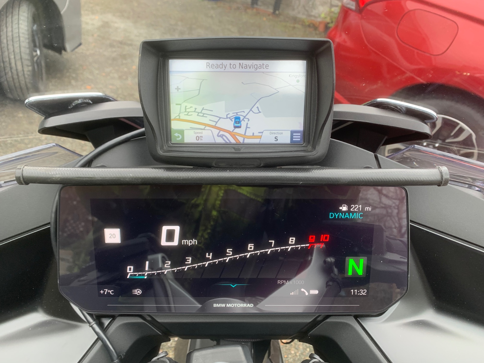

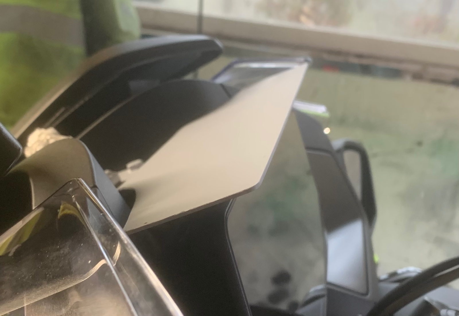

Yes - it worked!
All finished now. Made another couple of cuts to allow the speaker blanks to be removed easily to get at cabling. The GPS head picked up a signal at about 20s.
Applying the copper sheet anything like flat/smooth was like wrestling snakes!!
At the same time I slipped in a bit of weather protection for the TFT connection pins behind the screen.
As a precaution the GPS cable is run clear away from the screen so that will need to be tidied up a bit.
The edges of the shield are well clear of the edges of the TFT to avoid diffraction.
Now for some roads clear of wet salt to ride on!!

After my first ride since Christmas it's a complete thumbs up for the EMR screen above the TFT.
Before leaving the driveway the Zumo 590 got a signal after about a minute and didn't lose it once during a ride out this morning into the hilly bit of Aberdeenshire.
On the way back I left off energising the accessories including the 590 until a couple of minutes after moving off from the cafe to come home. Normally the unit wouldn't get a signal while I was moving especially in the valleys between our hills - but again, after about a mile the signal was acquired and it stayed in solidly the whole way home which is about 26 miles.
I can only imagine that those who have ordered the FMS unit will be well pleased with their purchase!

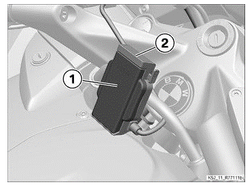

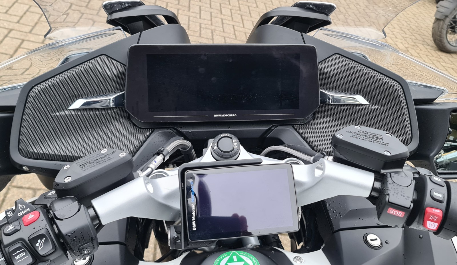

An update on the journey I have been on – no pun intended!
I ordered the FMS RFI guard as mentioned above, it arrived in good time and looks well made. I was hoping to “modify” it to fit the Wunderlich bracket already installed. However, it required quite a lot of machining to fit (should have brought the FMS bracket too!) and I don’t have the equipment to do so.
I was already booked into my local BMW dealer to have the locking mount (attached the Wunderlich bracket) replaced as it was damaged during installation. Before the appointment they highlighted BMW now have their own solution
and I decided to go that route, all BMW has to work! It is rubber mounted on the underside of the yoke – see photos.
On the 100 mile ride home it worked perfectly, it has the added benefit of being closer than dash mounted and easier to use the touch screen.
Hope that helps, Peter
