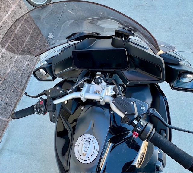

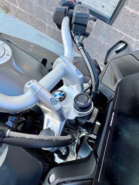

Hi Guys, I joined the forum today specifically because of a question on the GS handlebar conversion. I'm looking at buying a 2022 RT from a non BMW dealer. When I saw the bike, it did not have the normal RT handlebar setup I expected. It looked like some aftermarket conversion, which concerned me. When I asked the dealer about it, they said that the previous owner was military and bought the bike in Germany and shipped it over here when he came back. They said that the previous owner said the bars were stock (which I doubted). So my research lead me to this post.
From reading here, it appears possible that he could have ordered the GS bar setup from that factory, is that correct? The dealer does not have the original RT yoke or bars, so my next question is: Anyone know how much it would cost to convert back to the stock RT configuration?
I've previously owned a 1200RT and both 1150 and 1200 GS, so I'm familiar with the RT and GS. I'm not necessarily opposed to the GS bars on the RT, but I'm thinking down the road when it comes time to sell. The GS bars may be a little off-putting for some, so I'm trying to determine what it might take to put it back to stock RT.
Here are pics. It looks like it's probably the factory installed GS setup with the addition of owner installed risers. Does that seem correct?

MotoGary wrote: Thu Oct 31, 2024 6:04 pm Here are pics. It looks like it's probably the factory installed GS setup with the addition of owner installed risers. Does that seem correct?
Yes, going from the pictures that looks like an OEM GS bar set up with additional aftermarket bar risers.
