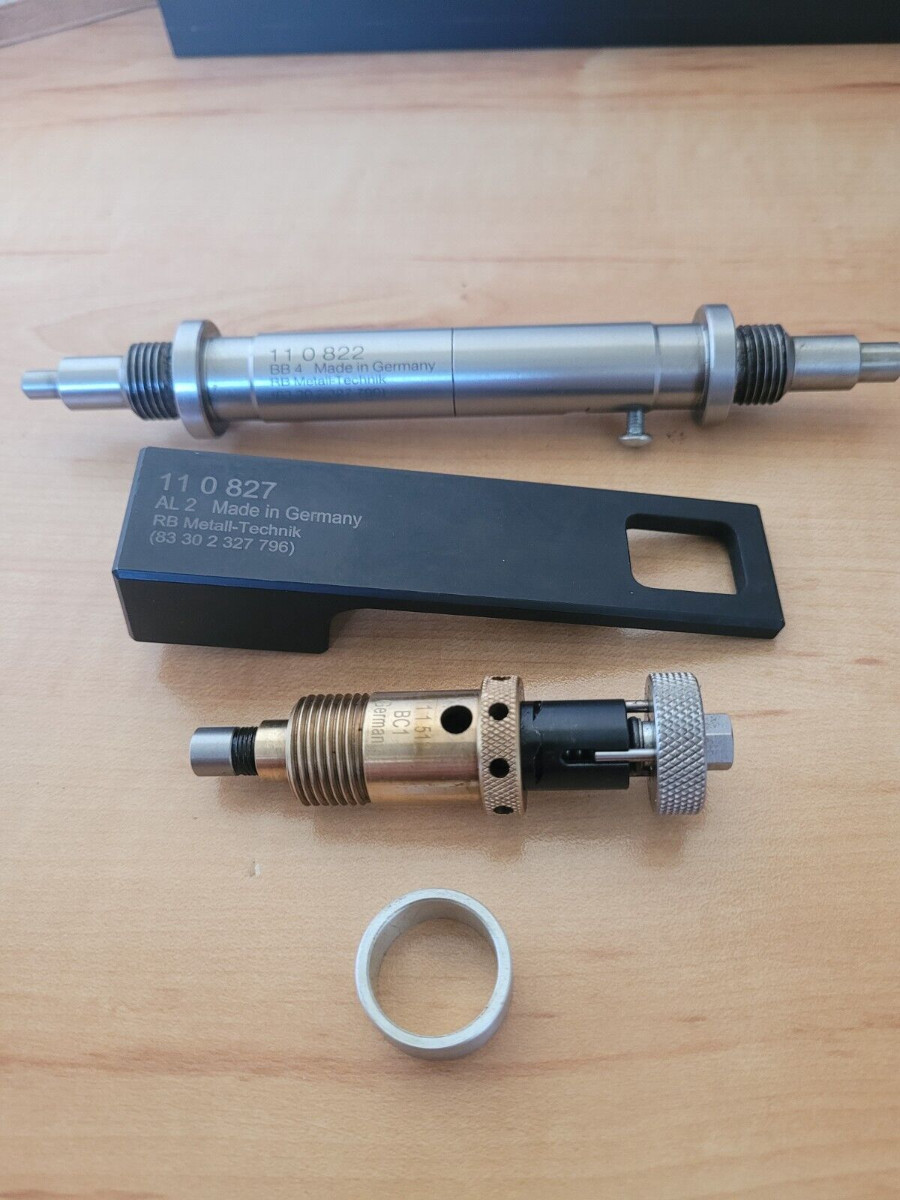

All the Parts from MotorWorks came today. The timing jigs and the engine turner are Genuine BMW tools.
Just the TDC/BDC locking pin to come.

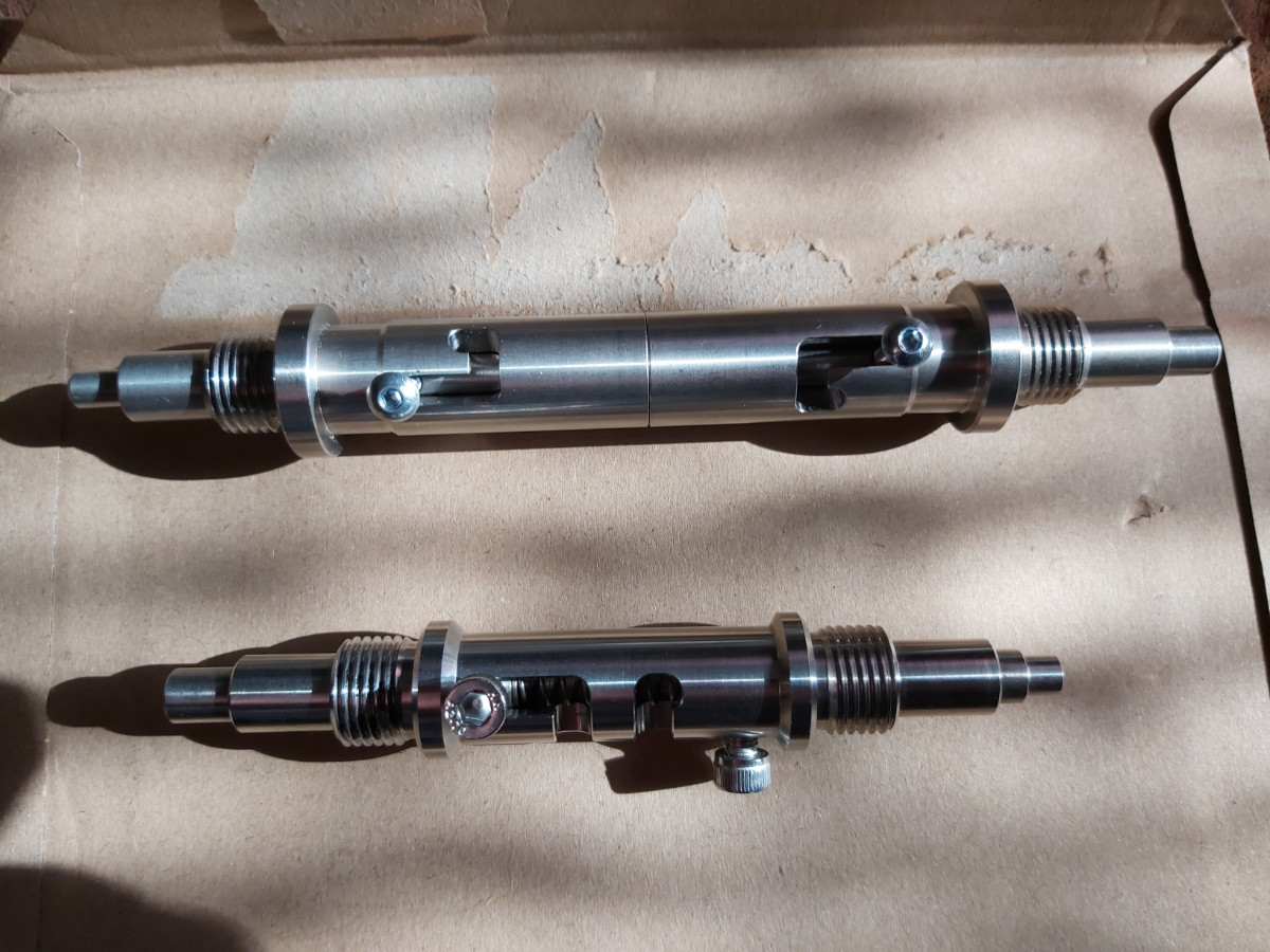

As i said in a earlier post i said i brought a cheap locking pin.
Well i found a genuine one for sale at half price so i brought it.
Today the cheap one turned up. So here is a photo i the 2 together.
The bigger one is the genuine bmw tool.
