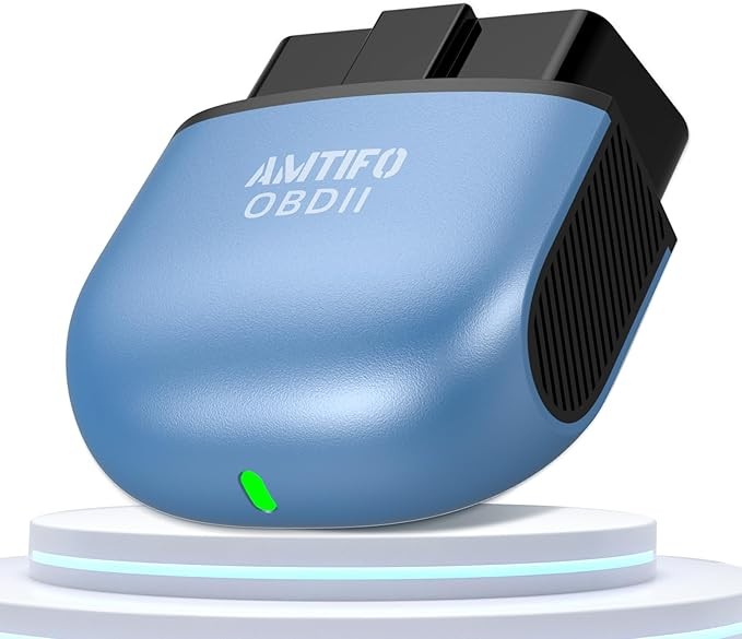

The unit looks like this:
I'm hoping the packaging will recommend something.
This is still all new to me!
I'll get myself over to Amazon and see if I can figure out what cable it needs. Not sure exactly what this cable will be called or where to find one. I'm hoping the packaging will recommend something.

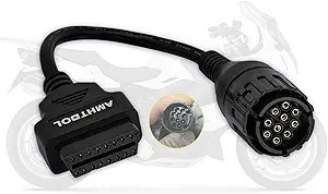

I'ma guessing this is the cable:
I'll order one just in case . Wow I hope this $20 unit can clear the message. The local independent BMW mechanic wants $60 to do it!- Strat Tuner(Yamaha FJR 2012, BMW r1200rt 2008)

I did need the cable to connect that $20, blu-tooth, device.
It connected.
It gave information about the engine over it's own app.
That app is tailored for BMW cars, not motorcycles.
The information was generic : RPM, error codes, oxygen mixture even
BUT (I like big buts)
It didn't offer much to an R1200 owner.! There was NO way to detect let alone clear the "Service Message"
Just thought you'd like to know!
