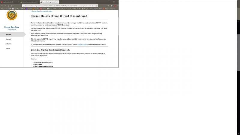

New 2022.10 maps downloaded onto Zumo 660 without issue. However, cannot get them onto my laptop despite never having any issues before. It goes through the entire downloading and updating process but I get an error message at the very end and the maps and Basecamp are not loaded. Tried uninstalling and installing all of the software, GE, Basecamp and the maps several times but no joy. If I load Basecamp separately to the GE process, I can see the maps but they are locked despite having lifetime updates.
Swapped a few emails with Garmin but no success, their website support says to contact Garmin for unlock codes but they say that they do not give unlock codes? Waiting for them to come back to me.

paynes1 wrote:If I load Basecamp separately to the GE process, I can see the maps but they are locked despite having lifetime updates.
Can the maps be unlocked from the Map Product Manager. These are the maps I have installed on my desktop PC.

Full EU still on SD card.Map Product Manager shows them as locked with a button to unlock online, which when selected takes you to the Garmin site. However that fuction doesn't exist now according to Garmin??
