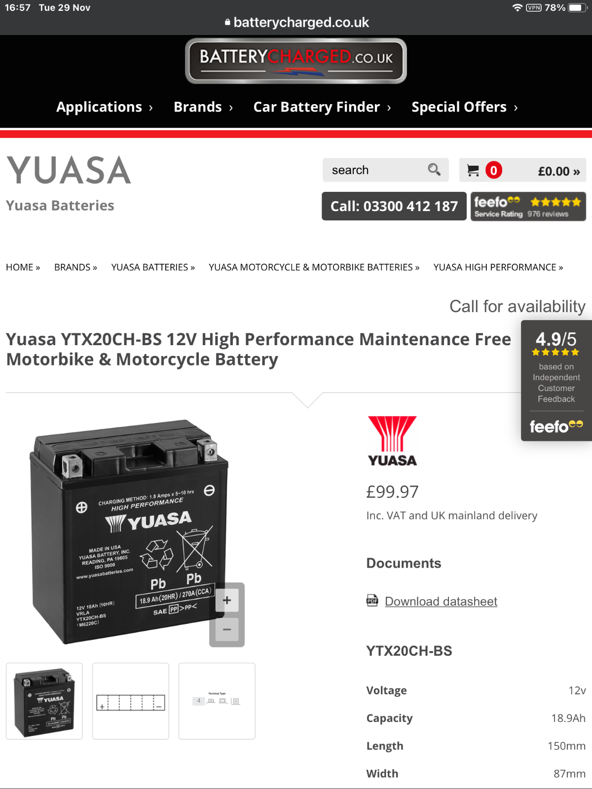

I prefer this price, it arrives tomorrow.
https://www.batterycharged.co.uk/yuasa- ... 42032.html
