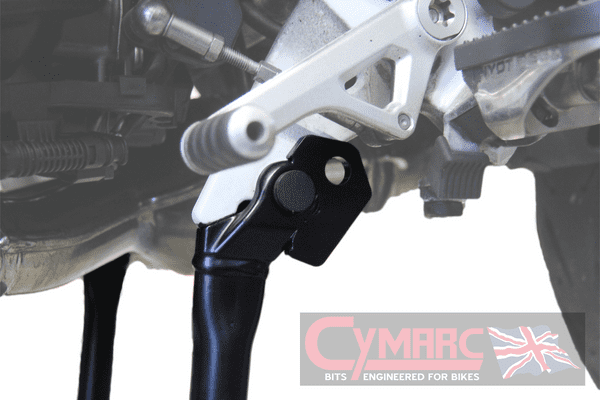

Cymark do them for the GS/A’s and they obviously make a profit… and I did suggest it several posts ago 🤣
We just need the shaped piece of metal and a diagram of the correct location (in exchange for folding beer tokens) then we can get it welded and send it off for powder coating ourselves.
Buy your SAKM’s Centre Stand Modification here folks!

sakm wrote: Wed Feb 22, 2023 7:36 pm Saw these advertised for sale for the R1200GS
Its a modification to the centre stand in exchange for a lot of money :shock:
It allows you to insert a lock through it so you can't take the bike off the centre stand which I thought was a good idea to stop any opportunist thieves while out touring etc

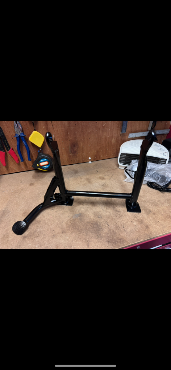

This is such a great idea, I am going to do the same.
I have bought a secondhand center stand to modify.
Two questions, what size was the hole you made and what model of disc lock are you using?
I understand that I could probably make the hole any size so long as the disc lock shaft fits and use any disc lock I choose but I'm curious to know?
I'm definitely doing this, I even thought about tapping the inner side, and using a wheel security bolt instead of the disc lock. I would then have to weld a short bit of tube on the outside as well to stop thieves access to the bolt head with a mole wrench or the like.
On balance, I think that is over complex, and I'll stick with your design.

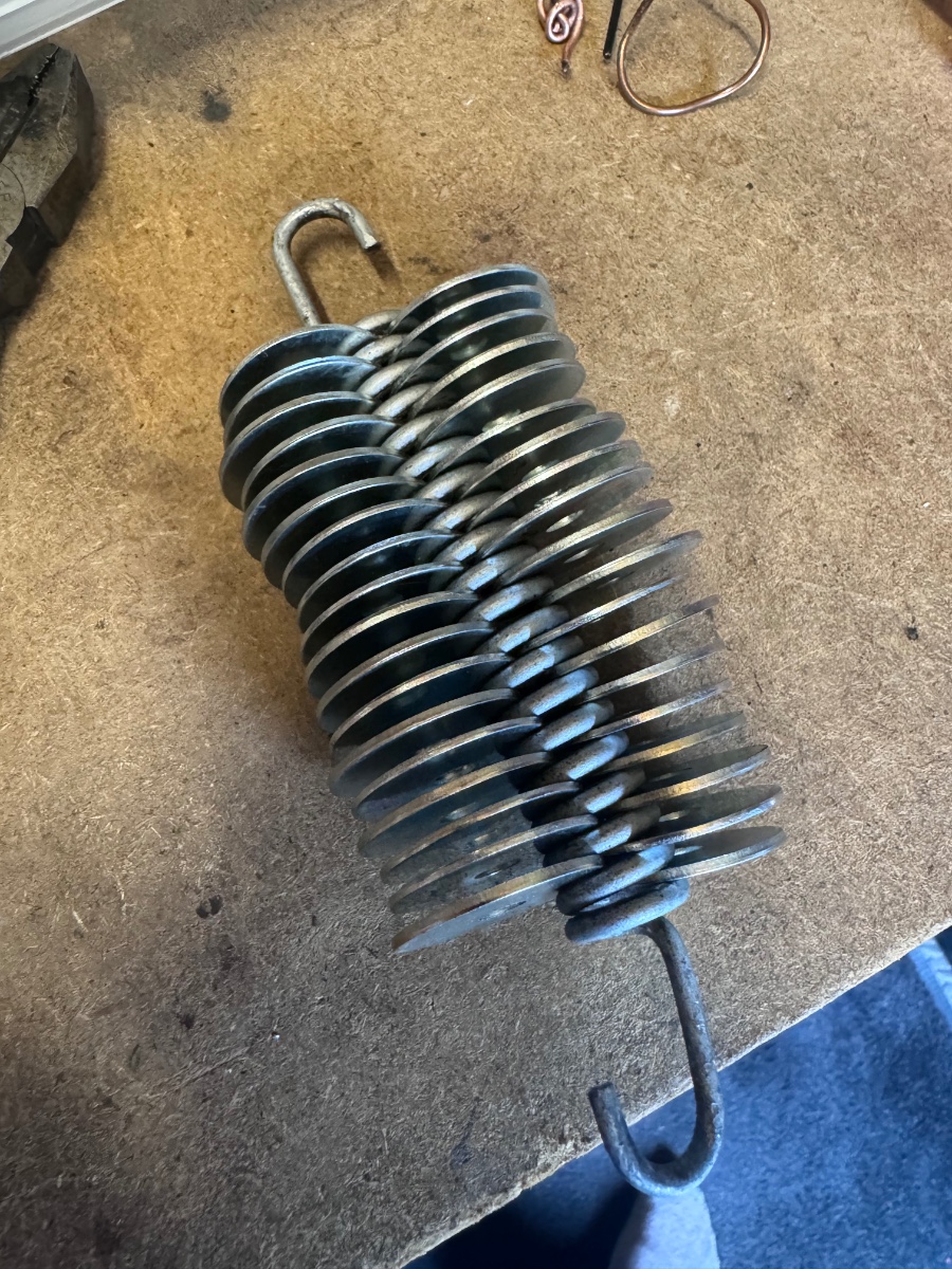

Incidentally, here is how you get stand springs off and on without risking your life!
https://kawatriple.com/tips/centerstand ... spring.htm

Well, as intended I have now done this modification as well.
It's a relatively simple mod but one that will hopefully add some extra security to your bike.

I did the washer trick to refit mine - worked a treat.

Re: Centre stand security
At last i found a main stand to do this mod to.
Its in better nick than mine so i will swap the stands over and mod the old stand.
£25 posted :-D
