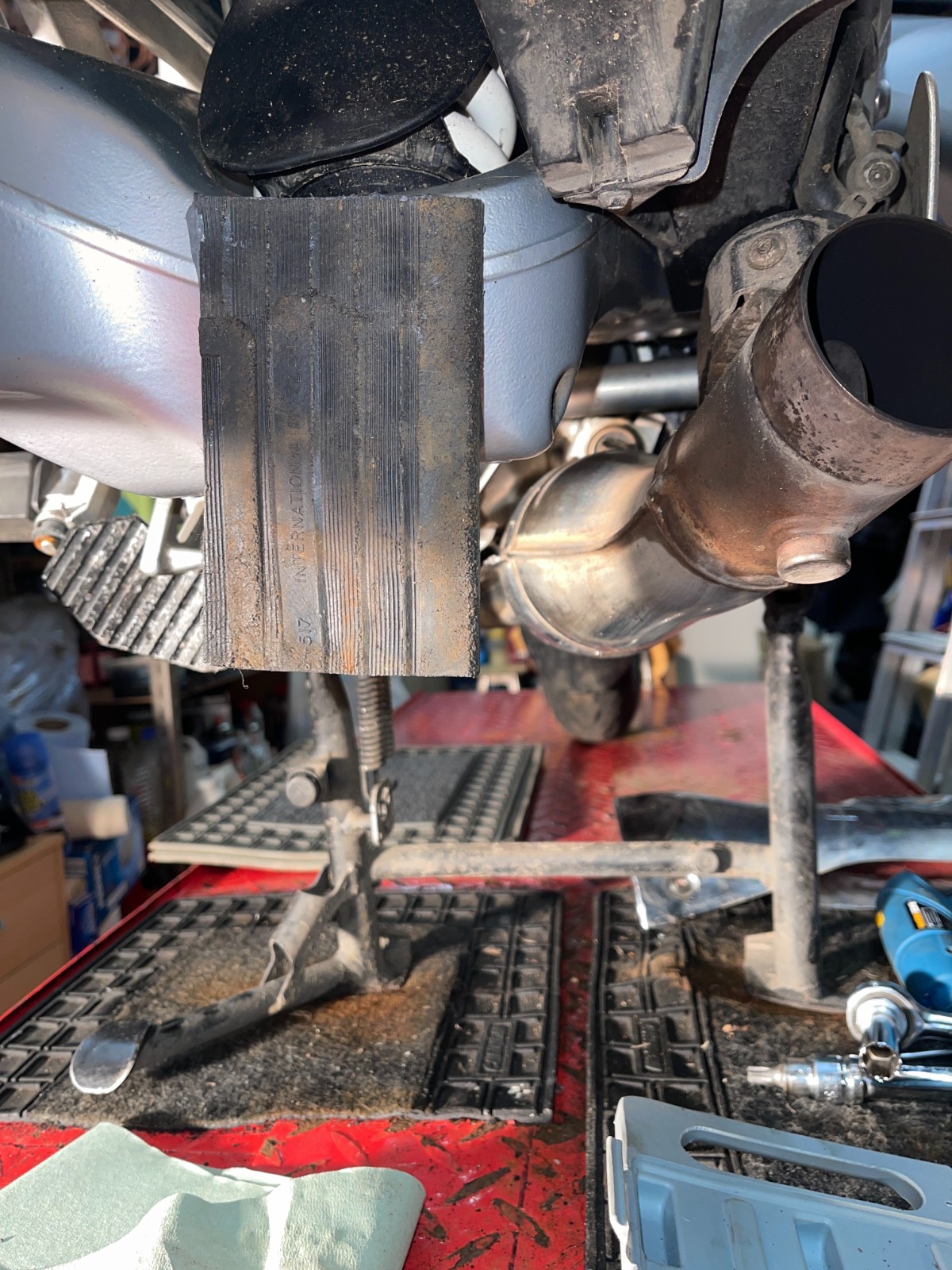

I have recently has my suspension replaced by Lukasz at T-Tech Suspension. I decided to purchase the rear spring in addition to the quoted spec/price (when we looked at the rear spring, although it was not "bad" there was signs of corrosion starting, so whilst the bike was stripped down, it was a no brainer to have a new spring as well.
Due to the "default" equipment I carry, Lukasz increased the preload on the rear unit. I now use "One-up" instead of "One-up with luggage" & the handling is vastly better & easily noticeable. We discussed the front unit & I made a spring change to that as well. So my suspension set up is "One-up" & "normal" damping.
I secured the rubber "mat" as shown in the photo, I have been out yesterday in the numerous downpours we had, since inspected the bottom of the rear unit & whilst it is not too cruddy (mainly due to the front mudguard I would suggest) I can see that over time, if not cleaned regularly, the same fate of the bottom bush seizing may happen.
To try & overcome this, I have purchased a section of 2mm rubber (200mm x 200mm) for £6 & will over the next few days get the bike raised on the ramp, drop the silencer out & attach a portion of the rubber to the front side of the swinging arm (opposite the matting) to protect the bottom of the unit.
When I know the "farkle" is working, I will upload another photo. (Apologies, I do not know how to rotate the uploaded image into the correct orientation)

Re: Swingarm lower suspension protection
Rossyuk39 wrote: Sun Jan 15, 2023 2:19 amI secured the rubber "mat" as shown in the photo.
How is the rubber mat secured. Was the rear shock splash guard retained when the unit was overhauled.

David. wrote: Sun Jan 15, 2023 10:52 am How is the rubber mat secured. Was the rear shock splash guard retained when the unit was overhauled.
Hi David,
Yes, the rear splash guard was taken off the original shock when it was removed from the bike & you can see it above my matting, it is the dark black oval shaped item, the new rear shock spring (white) can just be seen as well (which is held on with Sugru - https://www.amazon.co.uk/I000949-Moldab ... C78&sr=8-3
I have also used Evo-Stik epoxy putty - https://www.amazon.co.uk/Evo-Stik-32012 ... 78&sr=8-17 but I do prefer Sugru, (because with some applied heat from a heat gun it can be removed, the only issue I find is that I do not buy in "bulk" as it has an expiry date & if its "out" then it rarely works, you can be rubbing it & trying to mould it to no avail).
I hope that helps ... 👍
