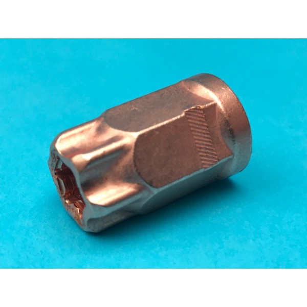

David. wrote: These nuts are described as 12 point or bi-hex, they are useful where access is limited.
Hence why a suitable socket is required, a 6 point or hex socket won't work.
Yeah, a 13mm what I like to call cheap socket fits a treat.

Ok so my bike goes up on the ramp today, service this week (if the oil filter arrives..) and I'm gonna make sure I can get the headers off before ordering the black widow set. I'm gonna soak them in plus gas, use heat (blowtorch), find a really tight socket. I've had advice to try nail varnish remover, tightening the nut ever so slightly. Any other hints, tips, tricks? Ta.

Last year I removed the silencer, then the header assembly to give my bike a deep clean. (It's a 2017 model bought and registered in 2016)
The nuts holding the headers to the cylinder head looked like those in the pictures posted by David of the GS headers.
I assumed they were external Torx nuts and used an external Torx socket (I could check the exact size if it would help).
The nuts came off and were replaced without any problem, other than the conflicting numbers for the make-up torque.
I'm no expert, but I don't think a 12 point socket is the tool to use.

Yes that would help if you think it's the correct information.
Re: What do you use to keep your chrome exhaust shiny?
My understanding is that Torx fixings are 6 point.
This is an example of a M8 exhaust manifold nut with both internal & external fitting.

I've got a Torx set as my Triumph has quite a few of them fixings, the BMW manifold bolts are nothing like.

Success! All 4 off, copious amounts of plus gas, a bit of heat, and off they come. Thanks to Simbo for the tip re an old 13mm socket.
