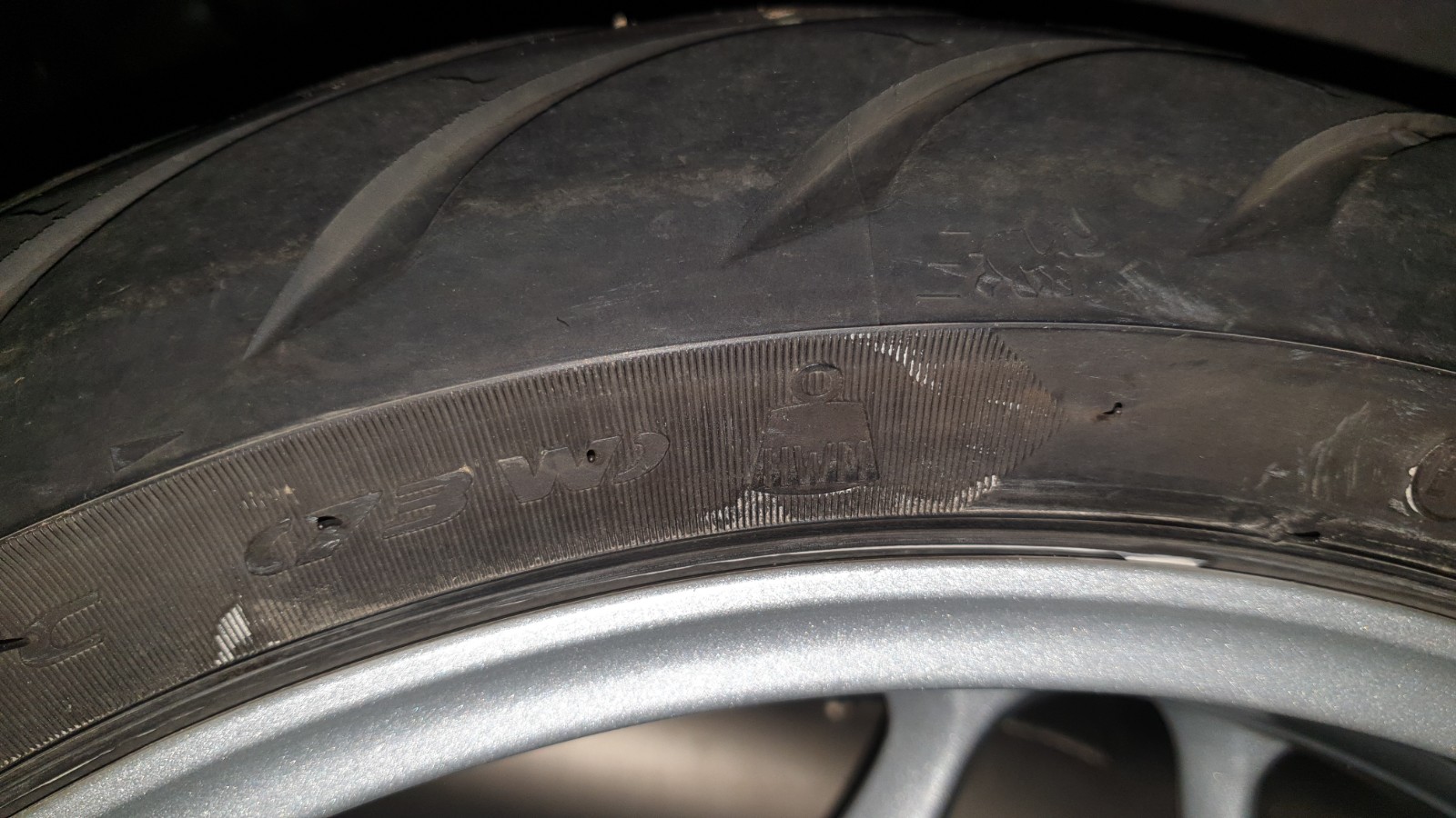

My RT had Metzelers on it when I purchased it second hand. The rear tyre is a 6 year old Roadtec 01 heavy duty tyre.
I have been quoted AU$400 (fitted) to replace it next week after it has done its last 1500km trip. It sticks brilliantly in the wet and hasn't caused any significant posterior puckering events to-date. I have no desire to change tyres even though I have had good service from Michelin tyres in the past.
In the following image the Roadtec heavy duty symbol can be seen:

My roadtec 01 that i have fitted are the standard ones, not heavy duty or the new SE model. Seeing there were not any "heavy duty" tyres when my bike was made(2007). I do a lot of research on products before i buy, especially tyres and brakes. After talking to many companies, garages, and people who use the tyres the conclusion came down to my 07 Rt is under the borderline regarding H/D tyres. If i had a K1200 upwards then a H/D is needed without questions. With my tyres ive felt no flex or handling problem. I inflate my tyres at 36F 42R for normal one-up riding. They are still noisy at 6000 miles but no grip has been lost. In Dartmore i did have a couple of times the rear twiched a bit but the was down to loose gravel and the normal grip was reganed within a nano second. In all, they are wearing better than when i had them on the Tiger and this time i should get nearer to the 9k mark before buying another pair

My 2007 Hexhead came new with factory fit Metzeler Z6's. The rear had a version code (C), not a standard tyre. For one-up (solo) riding they were inflated as recommended to 32F and 36R.
I've used none version code (HWM) tyres both one-up and two-up with luggage. The tyre pressures were adjusted to 36F and 42R for the latter. I've never suffered any ill effects or reduced mileage with none version code tyres.
