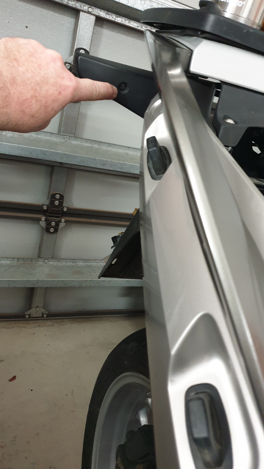

Re: Extra brake lamp.
Post by Marvin2Shoes »
No tupperware on the 2011 model (they couldn'tbethat much different could they?)... just two screws, one on either side of the tail light housing on the 2011 model....
