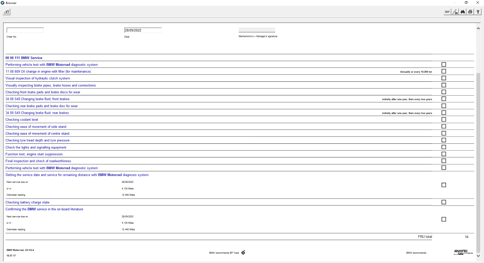

Taking some assumptions in that it was last service last year at 6k
this is what should be done in your next service at your mileage

Posts: 7694
Been liked: 248 times
Re: Servicing .
Agreed, oil & filter, F & R brake fluid plus visual inspections, job done.
Based on the FRT for my Camhead, I would estimate the BMW labour cost to be ~ £140 inc. VAT. Supply your own oil & filter should come to less than £200.

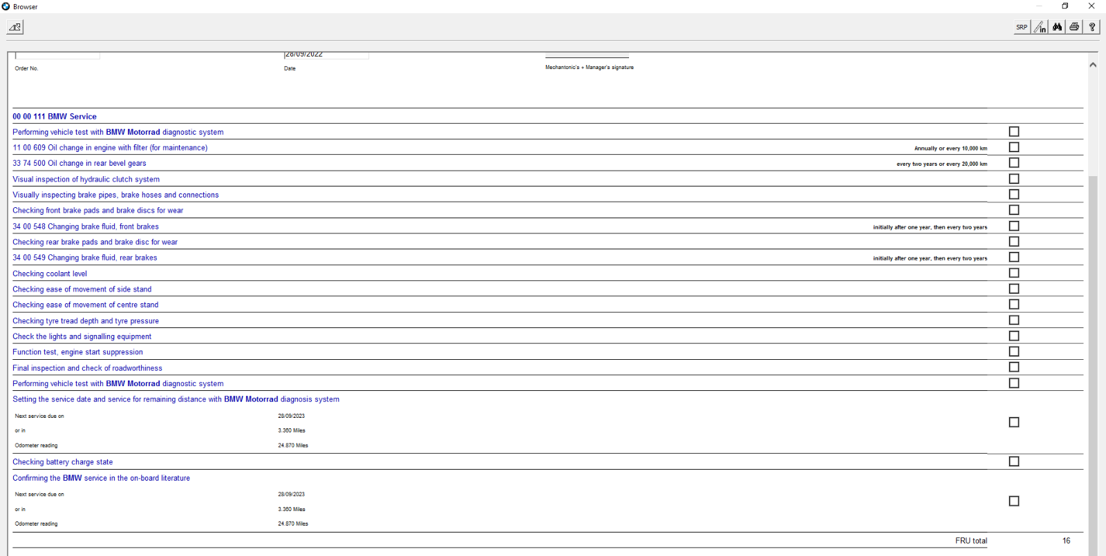

This is what I am getting done
A total of 16 FRU
Posts: 7694
Re: Servicing .
Hammo's doesn't need the clutch fluid or final drive oil changing.
