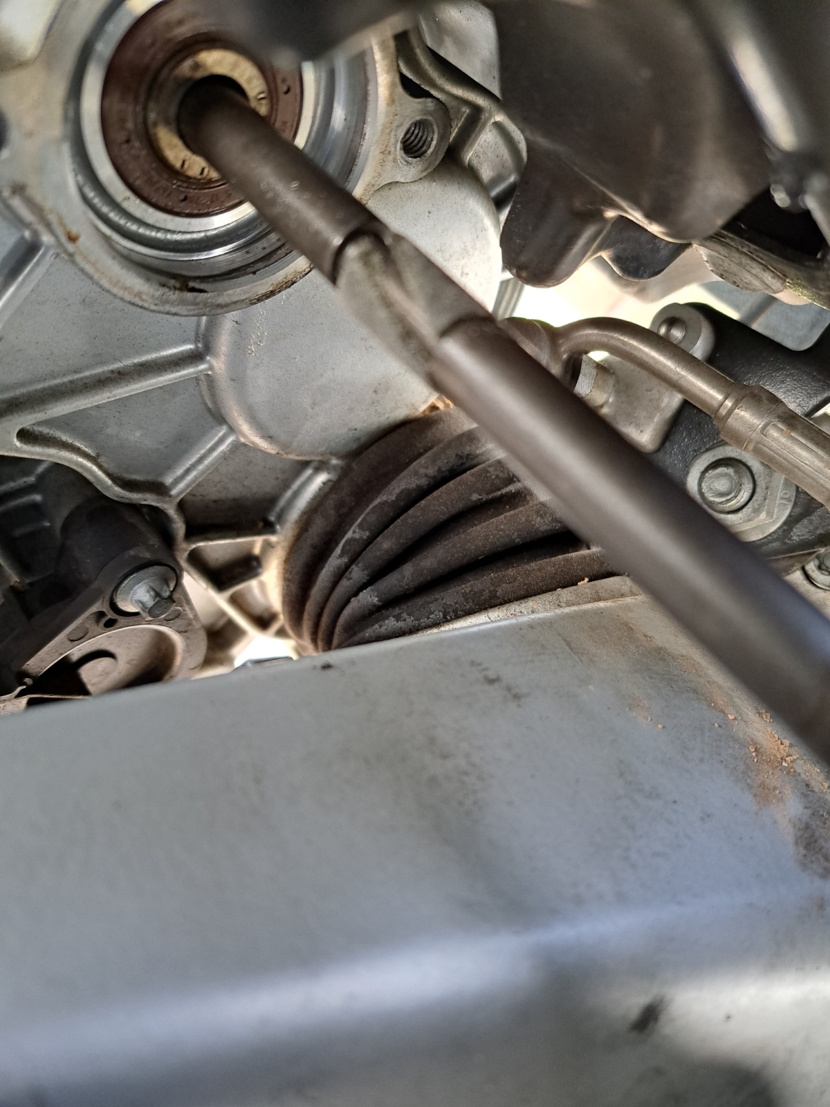

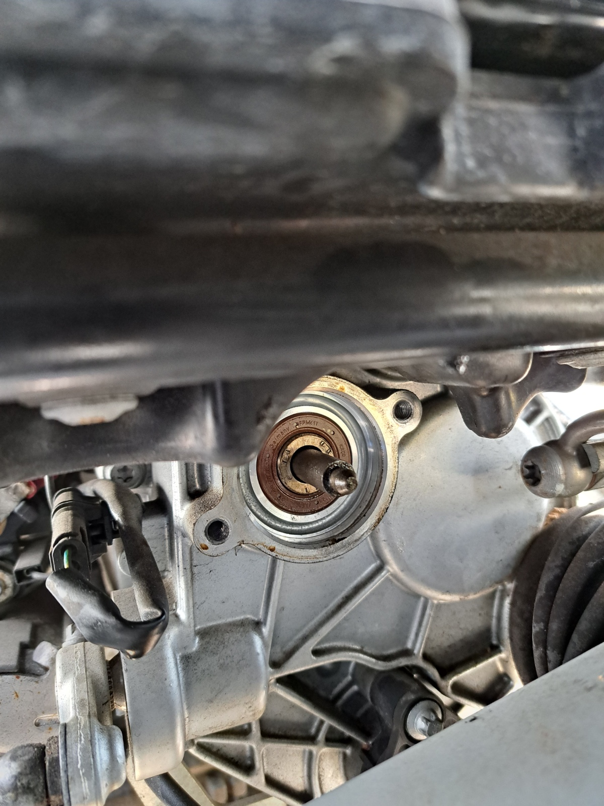

I am not even remotely intimidated. I have watched some YouTube and read several threads. Its not all that technically difficult, its just a lot of work. AND, as much of pita and $$ as it may be, the bike is going to be rock solid when I am done. The motor absolutely purrs. She is asking me very nicely not to wait to long to get her back on the tarmac.

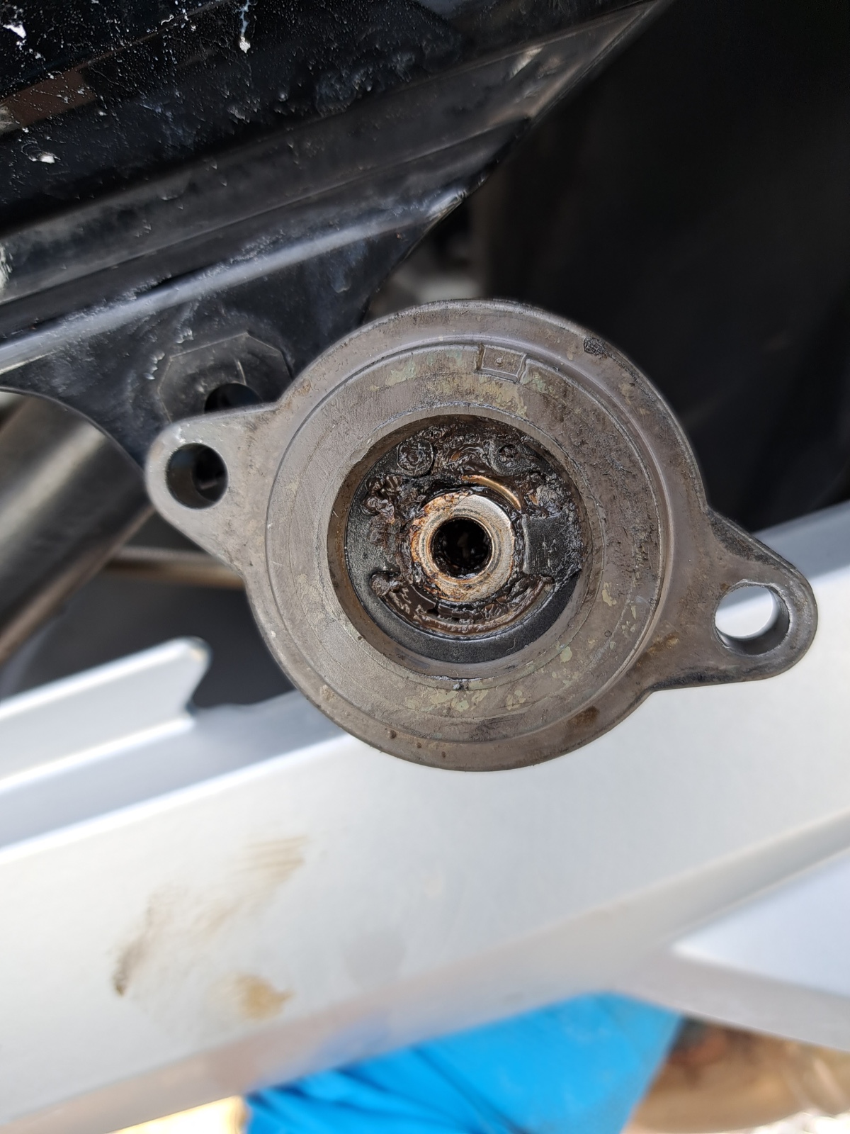

I pulled off the slave. Not sure if there is a detente that keeps the rod connected to the slave but it took a second to separate them. The slave has a bit of grease on the end, looks pretty normal.
The rod moves back and forth (cant remove it completely, hits the shock) but seems like it should have some lubrication, maybe not? There is a paper or felt "band" about midway down the rod that is split. Not sure what it does or if that is any kind of an issue. The rod spins while the motor is turning, assume that is normal.
I will say with the pressure off of the rod, the clutch quiets down quite a bit. There is some notable chatter coming from the clutch when it was assembled.

Did you try the bike in gear to see if the clutch friction was any better.
Have you tried operating the clutch lever with something in the hole where the push rod goes to see if it moves.

It will go into and out of all six gears but NO BITE.... so at least the gear box seems intact.
I did not try to actuate the clutch lever, its super stiff with the slave cylinder off?
The felt piece in the center of the pushrod is a sound dampening measure and should be corrected before I reassemble

From the Haynes manual:SD1 wrote: ↑Tue Jan 24, 2023 8:30 pmThe rod moves back and forth (can't remove it completely, hits the shock) but seems like it should have some lubrication, maybe not? There is a paper or felt "band" about midway down the rod that is split. Not sure what it does or if that is any kind of an issue. The rod spins while the motor is turning, assume that is normal.
"Note the location of the seal on the pushrod and renew it if necessary. Lubricate the pushrod with a smear of clutch assembly grease (BMW recommend Opitmoly MP 3) before installation."
- David.

Perhaps this is because the slave cylinder piston has no where to go. Can the piston be pushed back by hand.

Yes, with the slave/pushrod removed, the clutch should be transferring power to the driveshaft/wheel. It is either slipping badly or it is hung up and not making contact with the flywheel.

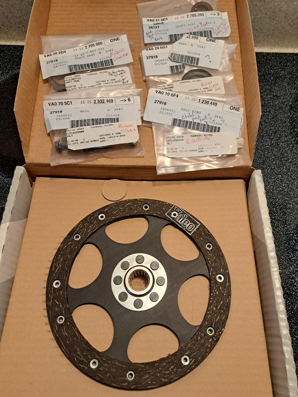

Its coming apart.... there is an internal issue and as of now, based on the previous use of the bike and the friction plate being the likely fail point, I don't think I have any other option than to crack it open and identify the problem and correct it.
I already have the friction plate, stretch screws, several of the shaft seals and the felt piece for the pushrod. I will need a few more things, but I have in hand the basics to get it going again.
Obviously I will assess when its opened up, but of the several vids I have watched, the flywheel and pressure plate are being reused and I am not going to replace them "just because". Same with the seals. If its clean and no outward signs of failure, I am not going to replace anything that doesn't warrant replacing. One caveat, if the seals are easy to replace, I am willing to do that as I already have them.

Not a huge issue, but watching videos, I have heard the felt piece on the pushrod referred to as a noise dampener AND a dust shield to keep clutch dust from reaching the slave cylinder.
