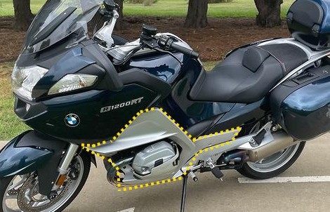

hi Folks, With reference to my attached photo, is it possible to remove just the fairing panel I have annotated in the yellow lines? Or do I have to remove other parts first, to access the screws before I can remove this piece?

Re: Side Fairing Removal
Posted: Sun Apr 02, 2023 8:04 am
by David.
You have to remove the other parts first.
Posted: Sun Apr 02, 2023 8:07 am
by Glenn
Remove the top fairing first, 4 fasteners.
Posted: Mon Apr 03, 2023 1:45 am
by 009jim
I found a couple of very good youtube videos on this after a lot of searching.
First you have to remove (a) the seat, (b) the tank bag holder, & (c) the glove box lid.
Secondly you remove the panel I have outlined in red in my photo below.
Lastly you remove the panels outlined in my photo in green and yellow. The green and yellow panels are one single piece.
Posted: Mon Apr 03, 2023 6:56 am
by Our Gee
When removing the screw located at the Glove Box note the different lengths.
