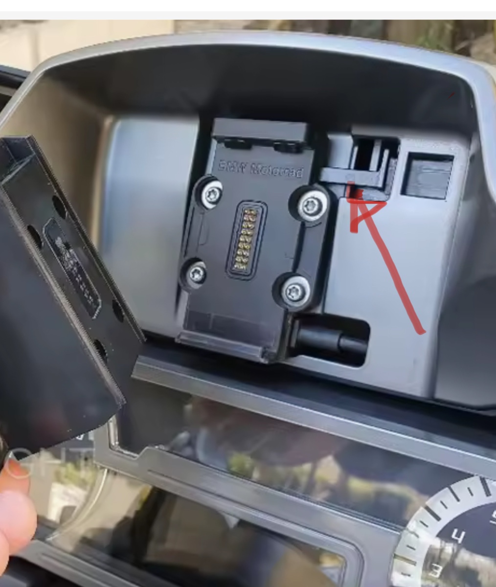

Resurrection of an old thread -
The eject button seems jammed, so can’t get the Carpuride out.
Despite removing the top plastic shield (and dropping one of the plastic screws onto the black rubber matting on the floor, never to be seen again) which has given me access, no amount of heaving, pushing, and cursing copiously will get the poxy thing to come out!
:mad:
Posts: 916
Has liked: 225 times
Been liked: 102 times
Re: Sat Nav eject button sticking
Had same problem with mine when not that old, but freed without removing anything. Now when wash always use air dryer to dry and operate function without nav or cover a few times and I've never had problem for years. Not saying guaranteed but seems to have solved issue for me, fingers crossed.
Has liked: 472 times
Having now removed the whole mount from the dash I saw that the plastic push mechanism had snapped inside of the casing.
The only way to remove the satnav was to cut away the lower mount with a Dremel, the unit now being useless anyway, which allowed the satnav to drop out. In fact the design of the mount has changed slightly from the picture but is fundamentally similar.
Official BMW dealer price £113.
