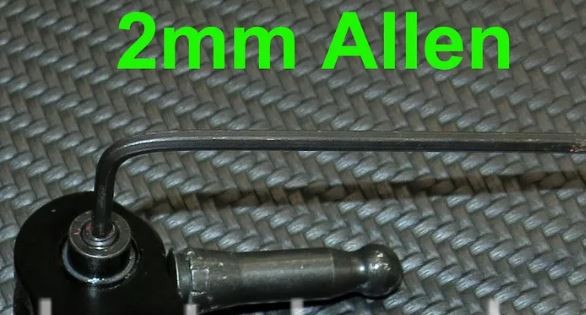

Re: Lever plunger ?
Panman40 wrote: Sat May 25, 2024 7:49 amI managed to mess up the tiny 2mm Allen grub screws you have to loosen.
Is this the grub screw in question which needs to be loosened to adjust or remove the plunger.
2mm Allen.JPG (44.27 KiB) Viewed 3578 times

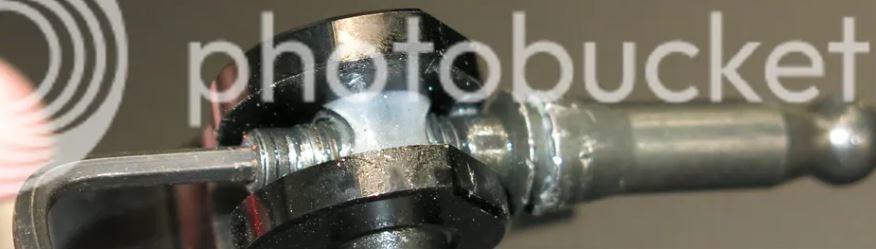

Adjusting the plunger.
Adjusting Plunger.JPG (34.86 KiB) Viewed 3575 times
