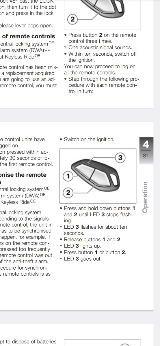

I’ve read the manual but it seems to refer to being able to set/unset the central locking system, but it doesn’t seem to do anything.
Re: Flashing red light on key fob
"If the central locking system stops responding to the signals from a remote control, the unit in question has to be synchronised."
The procedure for synchronising the remote controls is as follows:
Switch on the ignition.
Press and hold down buttons 1 and 2 until LED stops flashing.
LED flashes for about ten seconds.
Release buttons 1 and 2.
LED lights up.
Press button 1 or button 2.
LED goes out.
Posts: 916
Has liked: 225 times
Been liked: 102 times
David. wrote: Wed Nov 06, 2024 8:57 am "If the central locking system stops responding to the signals from a remote control, the unit in question has to be synchronised."
LED lights up.
LED goes out.
That is procedure to sync a keyed bike not sure if same for keyless as diffrent fob.

From manual. not sure what your asking Stu. Mine is keyed ignition but can activate central locking from handle bar button or key fob. Activate alarm from key fob only as far as im aware. button 1 locks, push 1 again alarms, button 2 unlocks and unalarms one push. if remember correctly. if push buttons or hold to long fob unsyncs from bike so follow procedure to sync again.
