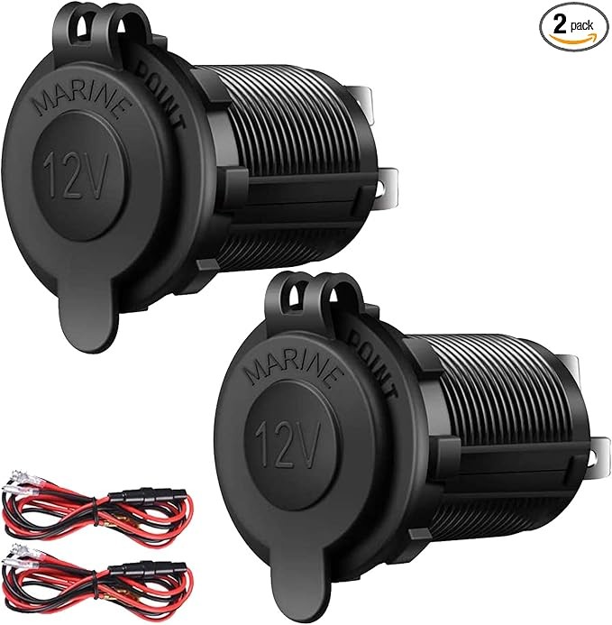

These two cost $9 on Amazon, and it's even fused for safety.

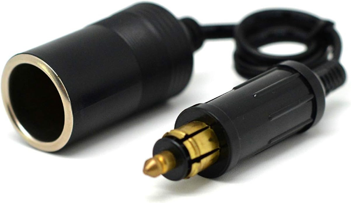

Re: Smartphone charge in top case
Kind of like This one (see below) that amazon has for $9. Looks to short, but it could be lengthened without too much effort.
