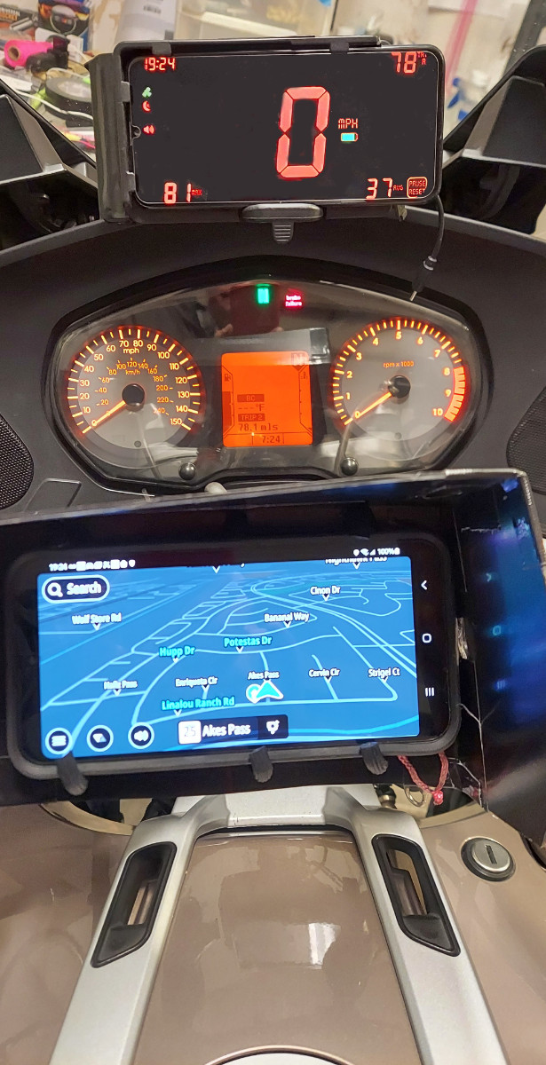

I thought I'd share how I like to have instruments set up. I acquired the 2008 R1200RT with that Garmin Mount above the tac/speedometer. It looked factory installed and already had its own power supply. I found an adapter that fits in where the Garmin went and replaces that Garmin with a clamp to hold a cell phone and gives me two powered USB ports!
This was a good thing since the 2008 Garmin wasn't what I wanted there. I located an old cell phone and put the android app "DigiHUD" on it. It displays current speed among other things. That's what I have there now . (See attached Photo)
The device below it is my current active cell phone running "TomTom" brand SAT / NAV (as they joked about on Gavin and Stacey).
It's mounted on two RAM brand ball mounts in a shaded bracket made from pliable plastic from a "Rubbermaid" brand waste paper basket.
The ball mounts are zip tied to the handlebars. I need that screen to be close so I can read it properly. It's powered by the outlet on the left fairing.
That power outlet, I presume, was meant for heated gear, but I found a plug in that surfaces two USB ports. I'd never seen that particular kind of power port before. It was very handy for powering my cell phone.
I have the same handlebar ball mount on my FJR. It's worked well crossing the continental US a couple times now.
The Garmin mount was not especially useful for navigaton. It's too far away. As a digital speedometer, it ROCKS!
I wish I could duplicate that on the FJR. Instead, I have digihud running as a small square on top of the tomtom software in the lower left corner. It's almost as good, but the BMW wins that one hands down.

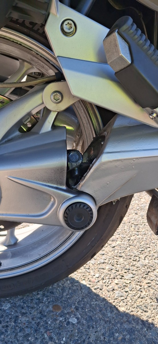

Cruising on Ortega hwy, 45mph, I noticed a vibration. No warning lights, no flat.
The vibration worsened. Was something stuck to my wheel?
More vibration. Time to pull over.
Rubber Shaft flex cover burned away. All shaft oil gone.
Call a flatbed tow truck for a ride to bmw dealer.
I will keep smiling. :-). Anyone car to say what he spent to replace a shaft drive.? That would help about now.
I wonder how one "Junks" a motorcycle? I presume the junk yard just carts it away after some paperwork.

You might be able get used parts from https://www.beemerboneyard.com/ or they may want the bike to part out.

Ted Porter's Beemershop has rebuildable driveshafts. Cheaper than OEM and they have good reviews.

Wow. I just got brave enough to go and look there. I don't know about splines and exactly which one to order, but the price was encouraging. $800 for a new one. (656 British Pounds) Even if the labor were 500, that would put the repair in range.1gewehr wrote: ↑Sun Jan 19, 2025 2:44 pm Ted Porter's Beemershop has rebuildable driveshafts. Cheaper than OEM and they have good reviews.
https://www.beemershop.com/product/r120 ... lines.html
I'd really like to restore and keep this BMW. It's my first one, a life-long dream bike, and I don't want it to be the last.

Drive shaft came in from BeemerShop.com.
That cost $1,000.
Harley/BMW dealer estimated $4,000 parts and labor.
My mechanic replaced shaft ONLY for $600 labor.
100 miles in the first day.
No problems yet.
That cost $1,000.
No problems yet.
