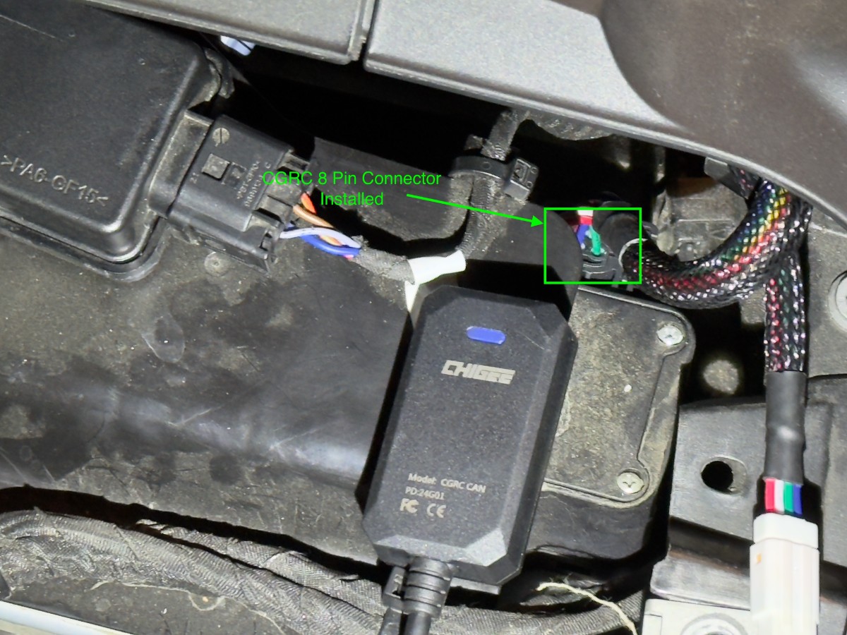

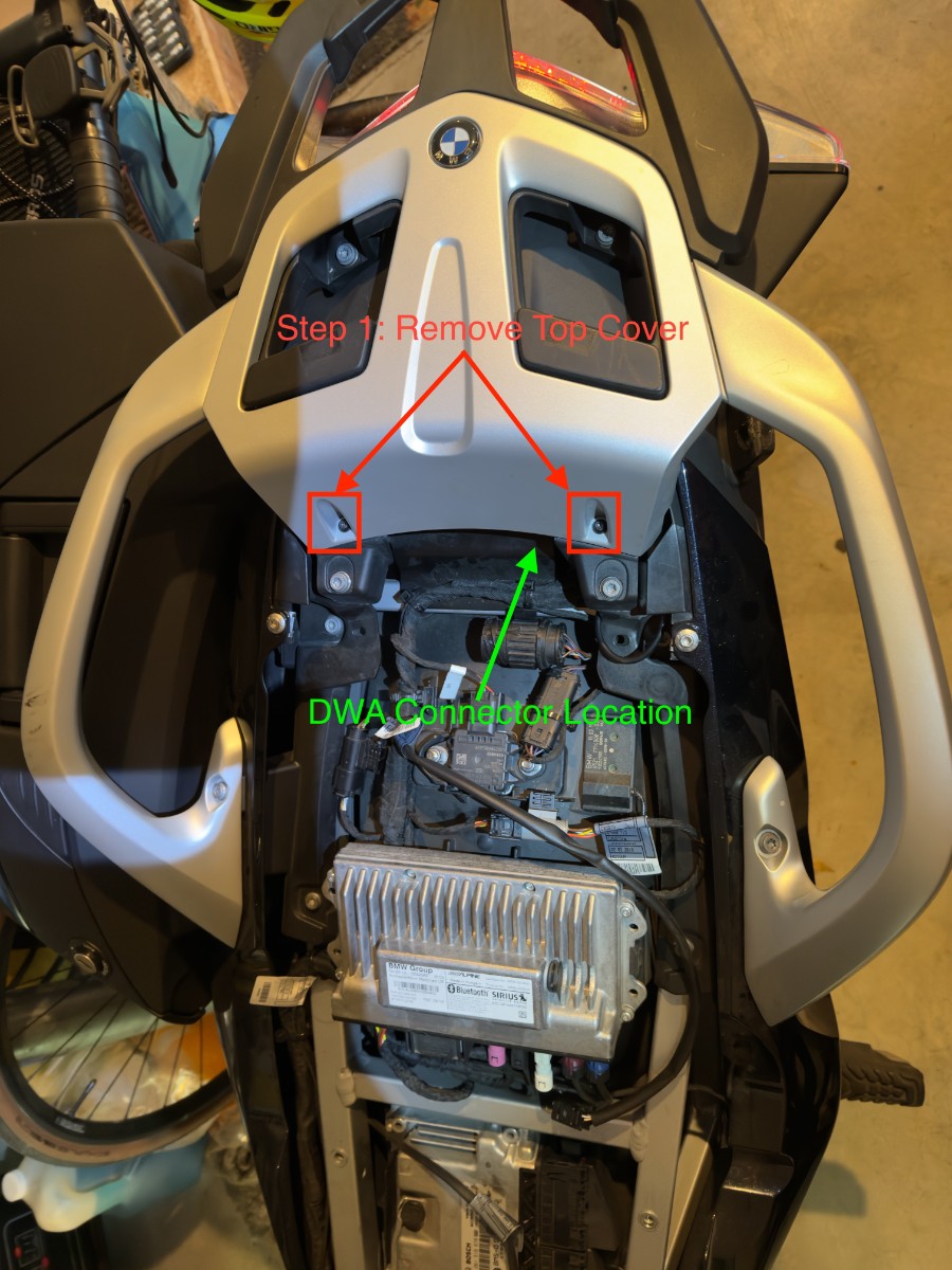

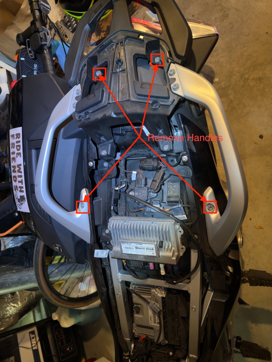

I was able to successfully install the CGRC CAN with 8pin DWA connector
The connector is located close to the tail light.
So you need to remove the top cover with BMW logo
Then remove the handles so you can access the connector
I was able to reach the connector and unplug existing connector and install the CGRC CAN.
If you can't reach you'll have to remove another cover (very tricky).
