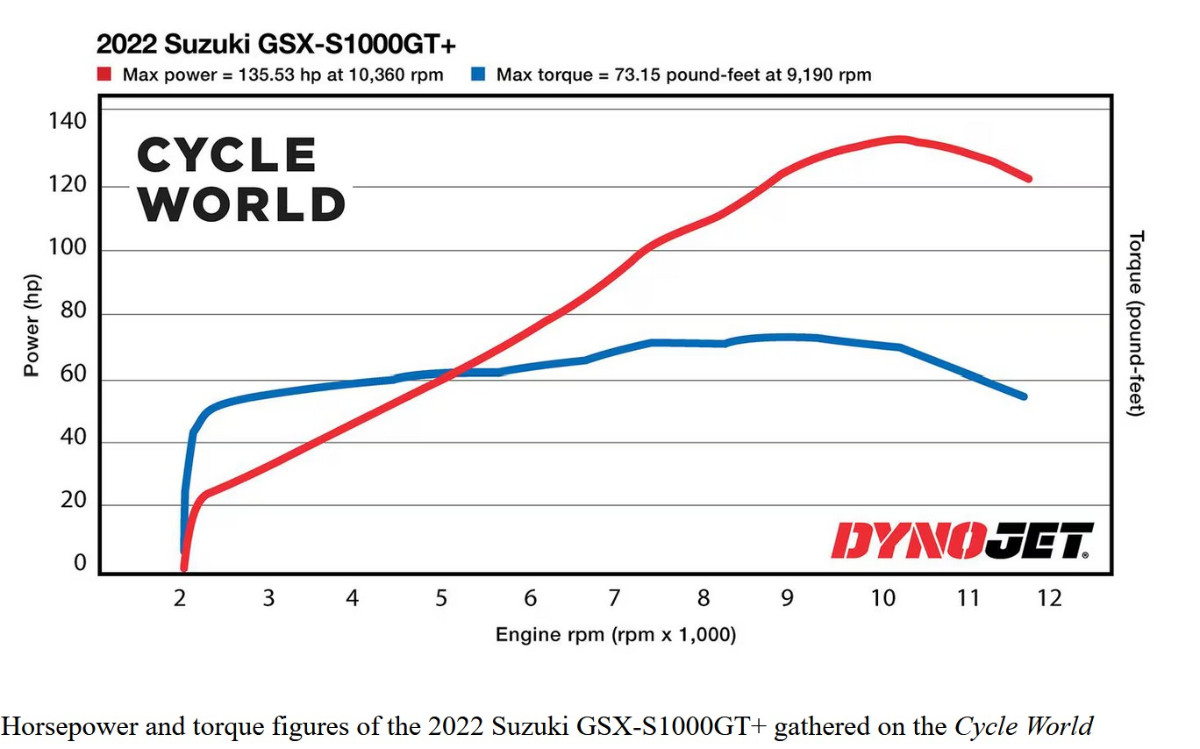

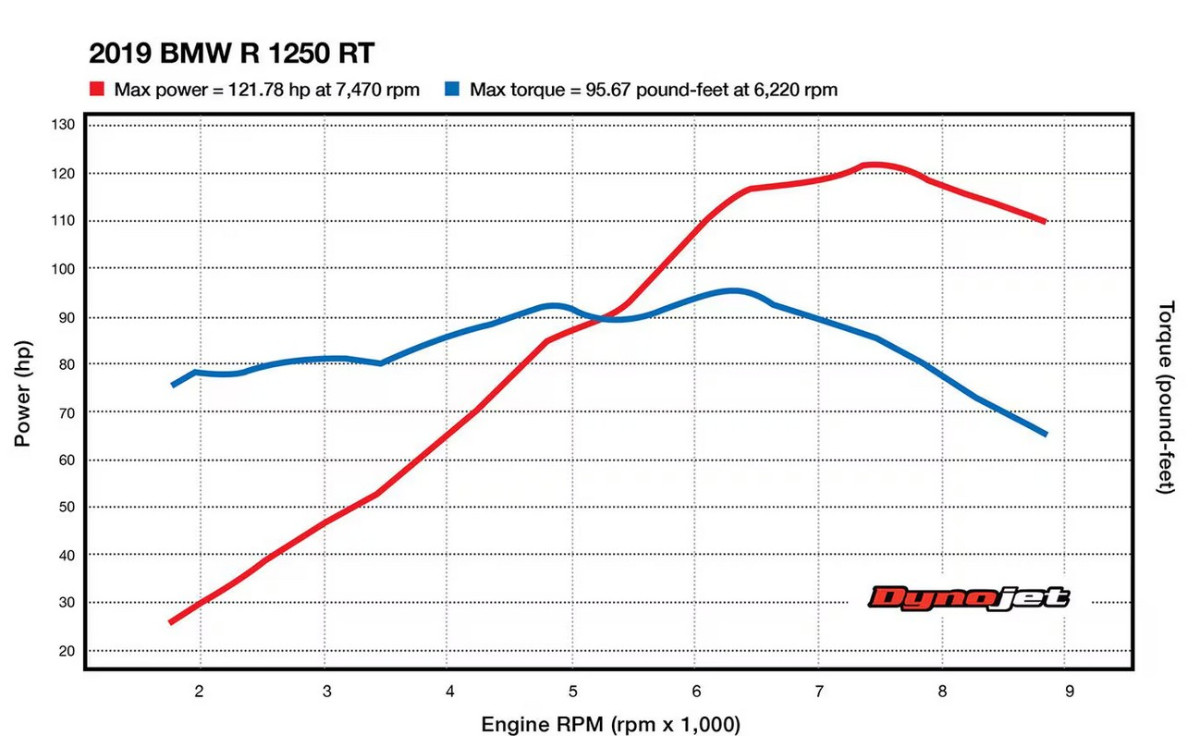

And that's one of the reasons I particularly like my 1250RT, it pulls like the Queen Mary. Compare the two torque curves below, (both back wheel on an independant dyno, so real world figures); one from a R1250RT and one from the Suzuki GSX-S1000GT+, both sold as sports touring bikes. Yes the Suzuki eventually has a nice curve to it, but it's down on an RT and doesn't get going until 3,000 rpm. Similarly with the BHP curve. One shall we say is definately sportier than the other, but do you want to be shifting gear all the time just in case. No, I'd rather have the low down torque please.
I did the same Bikesafe day as Glenn and my instructor also said about keeping revs higher, but I agrued saying my RT produced something like 40% more torque, it produces it a lot lower down the rev range than his bike does, that BMW have very kindly given me a little arrow to suggest when to change gear, that makes it a feature of the bike. Kind of diffult to argue against that and he didn't.
R1250RT Torque.jpg (150.93 KiB) Viewed 646 times
GSX-S1000GT+ Torque.jpg (133.83 KiB) Viewed 646 times

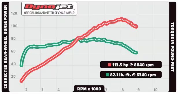

I’ll add the chart for we lowly 1200 owners too…
