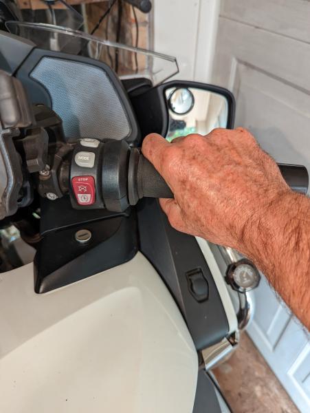

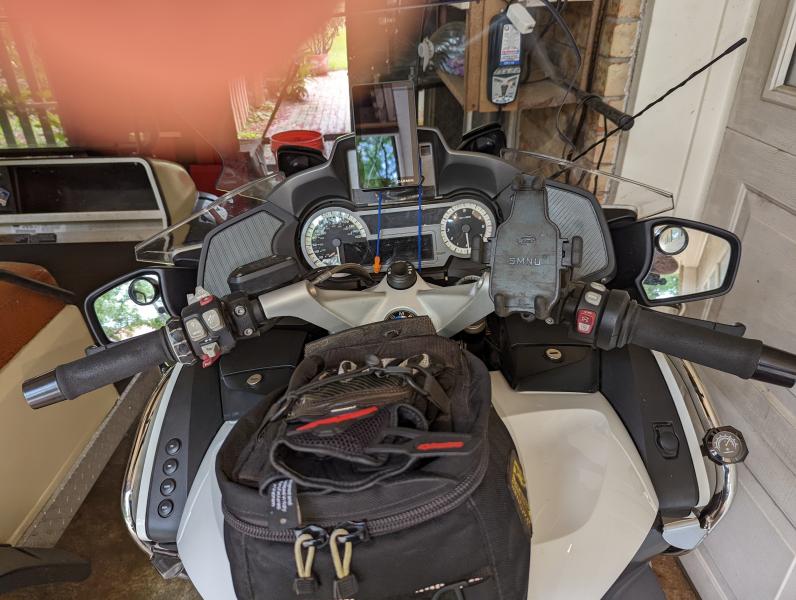

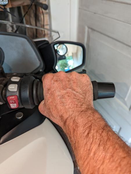

Maybe I have strange hands, but they don't seem to like the angle of the bars on my 2017 RT. It is my understanding that when riding my knuckle joints should line up with the bars as in the first picture. The problem is my knuckles look more like the second photo. I haven't seen anything on the market that changes the angle of the handle bars. Any suggestions?

Your arms, wrist, and hand should be in a straight line. If not this is when you get tingles in the fingers and a painful wrist. You get the same pains when using a keyboard for a long time as well. As for me, my arm length is short so i fitted a plate under the handlebars to raise and put the bars closer to me. There are a lot for sale on eBay. I think i paid around £20 inc delivery.
If i slump my back as per say a normal street bike i still get the tingles and wrist pain but if i sit upright everything seems to gell more and the pains are gone. Any lower back pains go as well after a long run. Ride the bike like your a police officer, with a straight back

Two options:
1) Have something custom machined like the Vario Ergo Risers - https://www.wunderlichamerica.com/BMW_R ... ser_Kit_98
But with some changes to the angles to accommodate your specific needs
2) Convert to the tubular handle bar and get a custom bend on the bar itself.

Thanks for the responses. It looks like I am just going to have to live to what I have
I was hoping for a simpler solution.

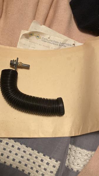

Try this DIY. Get a perforated steel bar from the hardware store and bend it to suit your hand/wrist angle, attach some flexible tubing - I used old vacuum cleaner tubing - stuff some foam rubber, etc. into the end of the tubing for firmness, find a suitable cap for the open end, then just screw it into the bar end.[/size] [/size]Be sure you make the bend,so it won't hit the tank or center console area when the bar is fully turned/locked. [/size] [/size]
[/font]
I did it on the left side only, for use when the cruise control is engaged on long rides while I rest my right hand in may lap, but you can use it on both sides if you like. I prefer to lean back against my load since it eases any back pain, show the device pictured here gives me about 4 inches of a rear word extension. If you prefer the upright posture, you can adjust where are you make the bend closer to the normal handle position. The way I have it placed, even if my hands are on the normal handle, it tends to lend some support to my wrist area. Here's hoping it works for you, but if it doesn't at least it's cheap![/font]
[/font]
