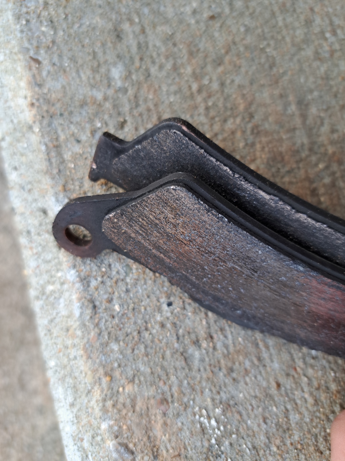

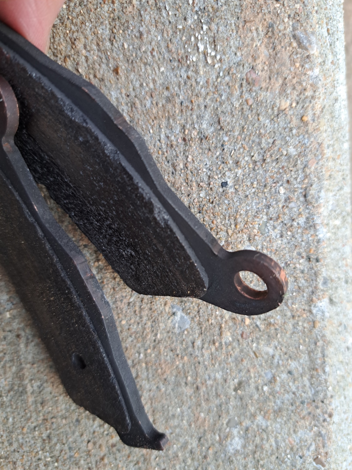

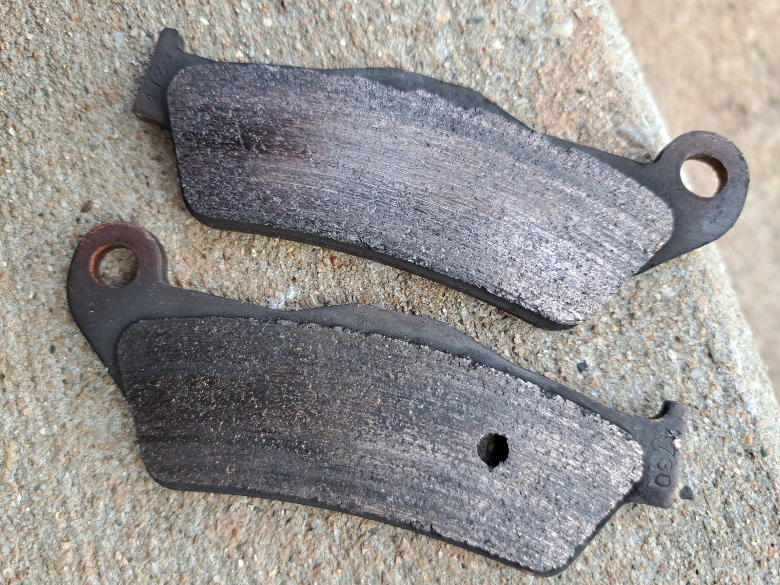

Here are the take offs from the rear caliper..... Not sure you can wear them any lower, the inside pad was almost to the bone....
Re: Looking for Organic EBC front brake pads
SD1 wrote: Wed Feb 15, 2023 1:09 amNot sure you can wear them any lower, the inside pad was almost to the bone.
From new, the BMW OEM inner pad is thinner than the outside. The hole is the wear limit, where the disc can be seen when looking through the wheel.

@David figured it was a wear indicator an you can def see through it..... : )
