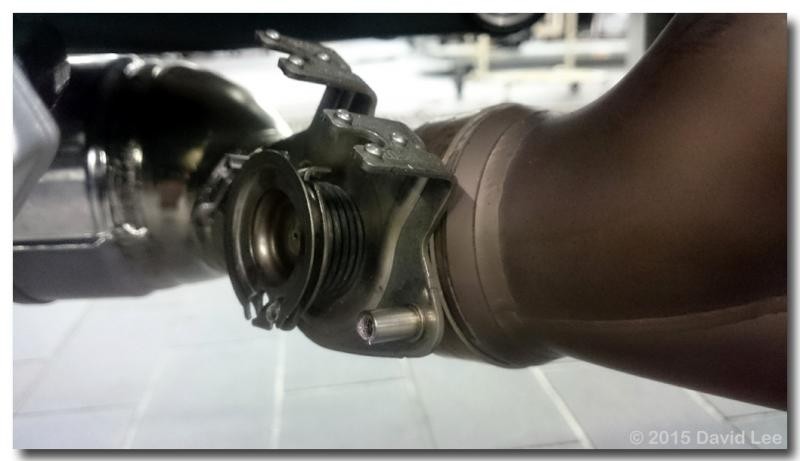

Agreed, the vintage ones are the best. My flap is still operational after 11 years and 43,000 miles. If it fails, it can be removed and a bobbin piece fitted.

The difference between the vintage bikes and the modern ones is that the flap spindle was in the horizontal position, nows it's vertical. I wonder whether this is a contributory factor the the more recent failures.
Re: Dodging exhaust flap bullets!!
Being vertical, i wonder if water is dripping in on the top ceasing the spindle. Whereas the older type, the water would run past the spindle
On the modern bikes, the bottom spindle bearing will also be contaminated internally with condensation from exhaust gases.

David. wrote: Sat Mar 04, 2023 11:20 am Agreed, the vintage ones are the best. My flap is still operational after 11 years and 43,000 miles. If it fails, it can be removed and a bobbin piece fitted.
My vintage bike (2011) had had the flap removed when I bought the bike 7 years ago with 15k miles, I can only presume it had been removed due to failure.

On my 2016 bike I had the valve replace within 12 months under warranty the valve went again about 18 months later I just ignored it. The valve both times stuck fully open so the only issue was a little extra noise at low speed, I saw no discernible difference in performance. On the 2016 model it did not add any warning lights
I wonder why BMW and the other manufacturers have not made this a separate section of the exhaust, a replaceable part that must cost considerably less than replacing the whole header for them to replace.
I now have the 2023 with TFT so I I guess I will get the engine management light if it stick, Once its out of warranty and BMW won't replace it FOC I will just buy an eliminator. It should not impact the insurance as it not going to increase the performance of the machine.

exportman wrote: Sun Mar 05, 2023 10:59 amI wonder why BMW and the other manufacturers have not made this a separate section of the exhaust, a replaceable part that must cost considerably less than replacing the whole header.
On a Camhead, the flap is a separate section which can be replaced but that's old fashioned.
