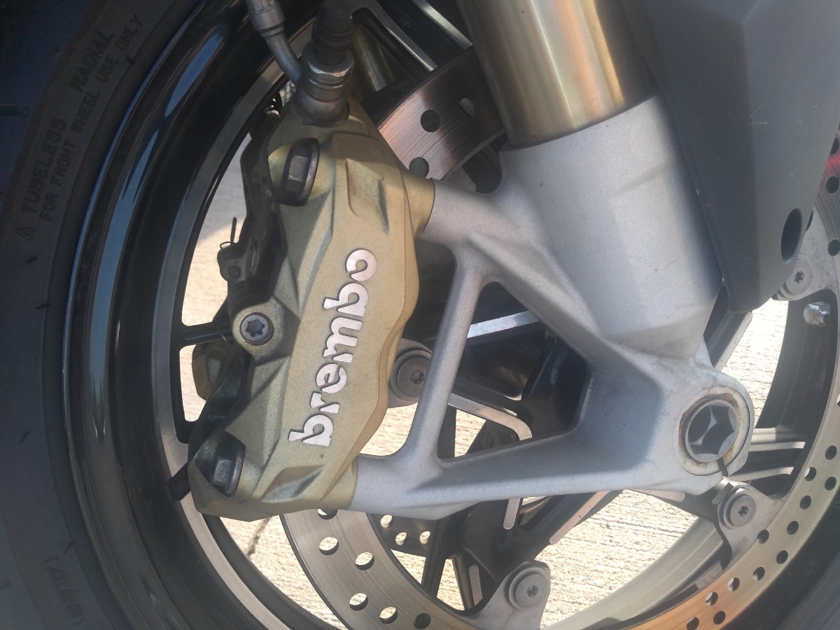

Is this what the Brembo calipers look like.

Yes, the gold Brembos were what was fit in place of the Hayes.

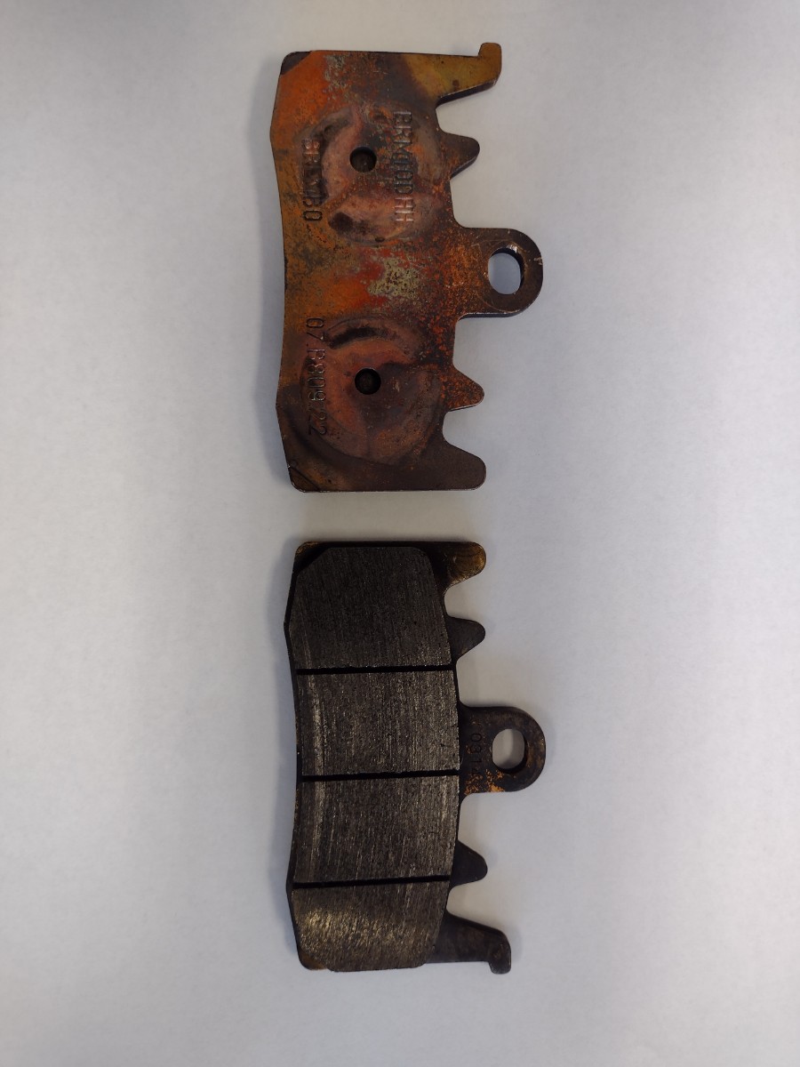

Can you take a pad out and provide a photo of it.

Here are the pics. The numbers on the back do not match a part number.
My local BMW dealer was not helpful.
I have been told EBC part No. FA630HH work. I have ordered a set and will let everyone know.

resipsa121 wrote: Tue Mar 28, 2023 9:42 pmThe numbers on the back do not match a part number.
The number looks like, 07.B809.22, same as those from Hornig.
resipsa121 wrote: Tue Mar 28, 2023 9:42 pmI have been told EBC part No. FA630HH work.
Look the same without the slots.
This ebay listing would seem to confirm that the pads removed from the bike are OEM part # 34118548028, supplied by Brembo.
