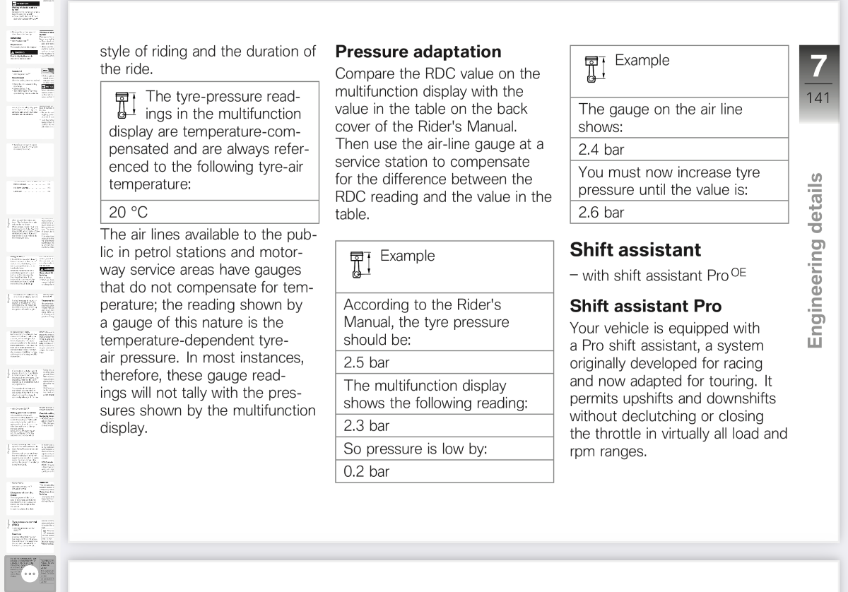

Post by Mac001 »
The tyres on my 2019 are measured at 20 degrees centigrade as a reference. That attached picture comes from the manual page 140 for my bike year. Other pages say set it cold but it is only when you get to this page that it explains how the system works. I have a really accurate gauge and at 20c it was spot on.
