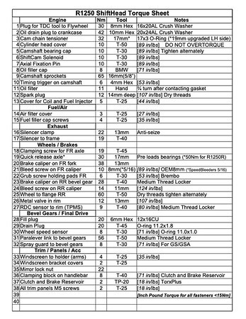

Hi,
Does anyone have a list of torque settings for the 1250 RT ? Doesn't seem to be an official BMW workshop repair manual or a Haynes one in the UK.
So any info would be helpful.
Thanks

Here you go. I believe this came from Boxflyer. Hope this helps.
Torque Values.jpg (66.58 KiB) Viewed 4557 times

Thanks bud, that's very useful. 😎
