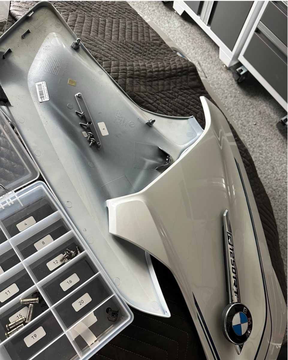

Boxflyer wrote: Mon Mar 18, 2024 8:55 pm There are 3 screws that are longer without shoulders in each engine fairing starting with the 2019 and usually no screw on the tank cover forward point under the each side glove box.
On the Torque Sheet, the new value for the rear Brake Caliper is 28Nm vs 24Nm.
I may make a completely NEW version of these for the ShiftHead in the near future...it's a lot of cutting/glueing and general "art work" to make these before taking a HI REZ photo so I can reprint them at the local FedEx Office store.
Brad
Funny, those are exactly the bolts that triggered my question about the updated diagram.
When I removed the panels in the picture below, I realized somebody used 2 different screws on each side, a long one without a shoulder and another one with a shoulder.
This does not seem right because the panels are uniformly thick, and the mounts they go in also look identical.
Just would like to figure out where the "shoulder-less" long screws are supposed to go.
Thanks!
