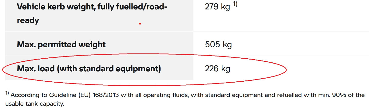

Taken from the current BMW Technical Spec Sheet.
Then there's you, have you ever weighed how much your boots, riding jeans, jacket, helmet and now airvest weigh, maybe x2. Take that off what's left of the 226 and honestly it ain't that much for a couple who've erm, led a good life and like to take their gadgets & creature comforts along with them.
Given the market that RT's is sold into BMW really do need to look into this, accept we carry more 'stuff' now and do something about it for the upcoming R1300RT.
So basically what they are saying is you're left with 226kg for the rider, pillion and all your kit, and remember that's for a bike with standard equipment. On an RT panniers are standard but a top box isn't. Neither are auxiliary lights, ESA, heated seats etc, they are all options, be it bought individually or as part of a pack / higher spec bike. Okay, some may only weigh ounces, but they add up and come off that 226kg.Then there's you, have you ever weighed how much your boots, riding jeans, jacket, helmet and now airvest weigh, maybe x2. Take that off what's left of the 226 and honestly it ain't that much for a couple who've erm, led a good life and like to take their gadgets & creature comforts along with them.
