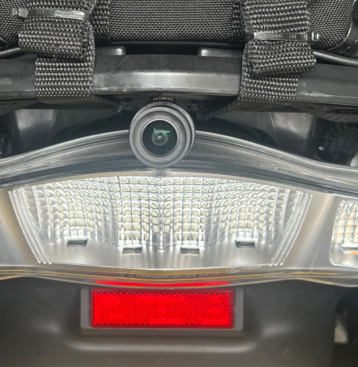

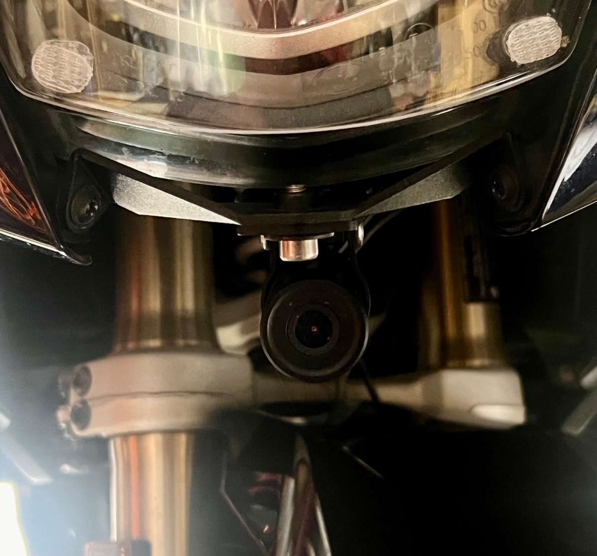

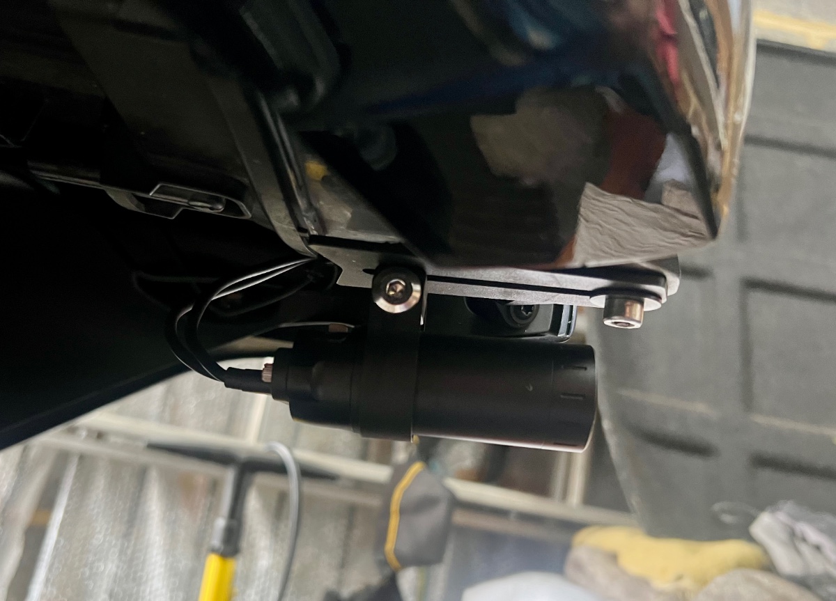

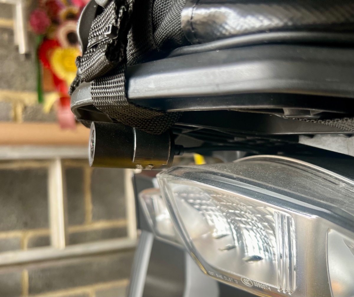

Having another look and I’m surprised how physically large the cameras are, do you have any suggestions or pictures on where the best place is to fit them ?.

Re: Innov K6 install ?
Here you go Martin -
