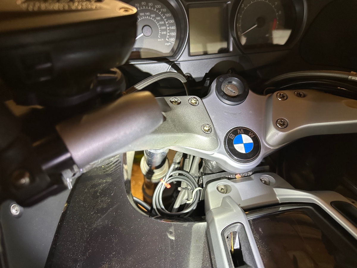

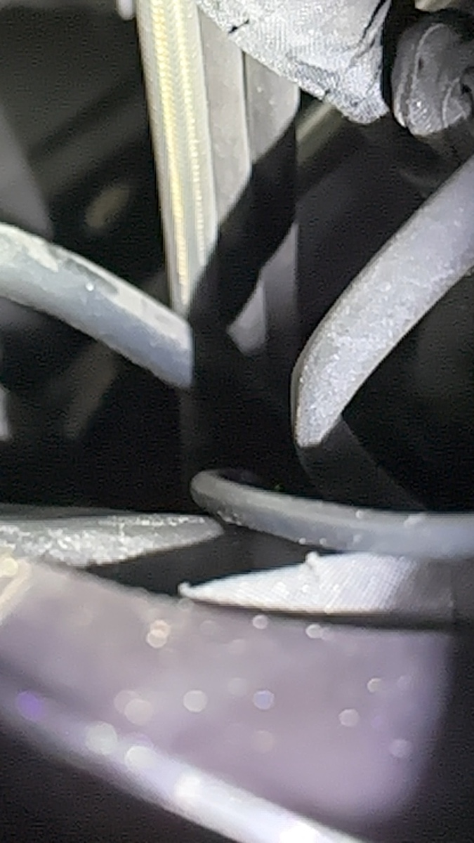

Unfortunately, this raises more questions than it answers. The video shows "rider right" connector, where the wire that I'm tracking down is "rider left" and does not connect into wiring high up on the bike but dives down into a netherworld screened by body panels. Time to see if I can post a picture...
If this worked, the first picture shows the coil of now unused wire zip tied off and the second picture taken from close to that coil looking down.The second shows the thinnest gray wire close to the left edge exiting frame of photo at bottom back to the coil shown in photo 1. The perspective is 90 degrees away from the perspective of photo 1. The first photo is inline, the second appears as an attachment, not sure why.
I suspect I will need to remove body panels to gain access to where this wire, which used to power a 15 year old GPS unit mounted above the dash, ties into the electrical system.
Thanks for the video, that explained a lot of stuff I ran into researching this question.
--ejc
--ejc
