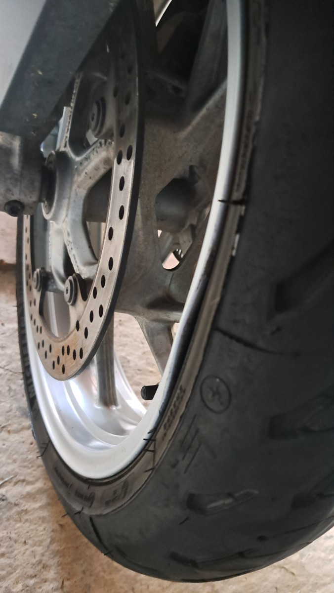

Went down a pot hole in wales last week, checking the tyres today noticed a deformation on the front wheel. The tyres holding pressure but the damage is obvious.
Collective thought's, is this repairable ? Or new wheel?

Looks repairable to me, had similar myself.
Re: Wheel damage
Easy repair is that
Re: Wheel damage
Easy to do on BM’s soft wheels
I had mine fixed here -

I had something similar a couple of years ago Motoliner sorted it for a reasonable cost

Booked in with motoliner next week. Ride in and out service.
Very helpful on the phone. Quoted 200ish plus the vat.

Went down to Motoliner today and got the front wheel sorted, 6 hour round trip and 4 hours in the workshop (ride in/out). 200 quid plus the VAT.
Thanks to Steve398, Panman40 and exportman for the recommendation.
