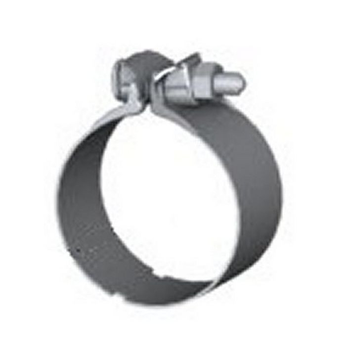

Indeed. This happened to mine at the last tyre change. The trye shop got it off, eventually, after much cursing & complaining and used a jubilee clip as a get you home bodge. I ordered a new one and put it on with a load of hi-temp grease on it, but I've added a remove, clean & regrease every Autumn & Spring to my 'in addition' maintence schedule. I kept the old one as I drilled the remains out, found a Stainless Steel nut & bolt that fitted, but now I know, hopefully won't need to use.
Silencer Clamp.jpg (32.62 KiB) Viewed 1249 times
