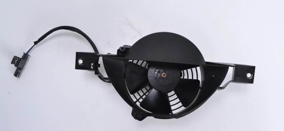

Re: Oil cooler fan
Sure, what do you need?
I bought the fan and shroud from the R1200RTP, then just install it in place, no adaptations needed.
I've already described here how I made the connections, but if you have any doubts, ask.
