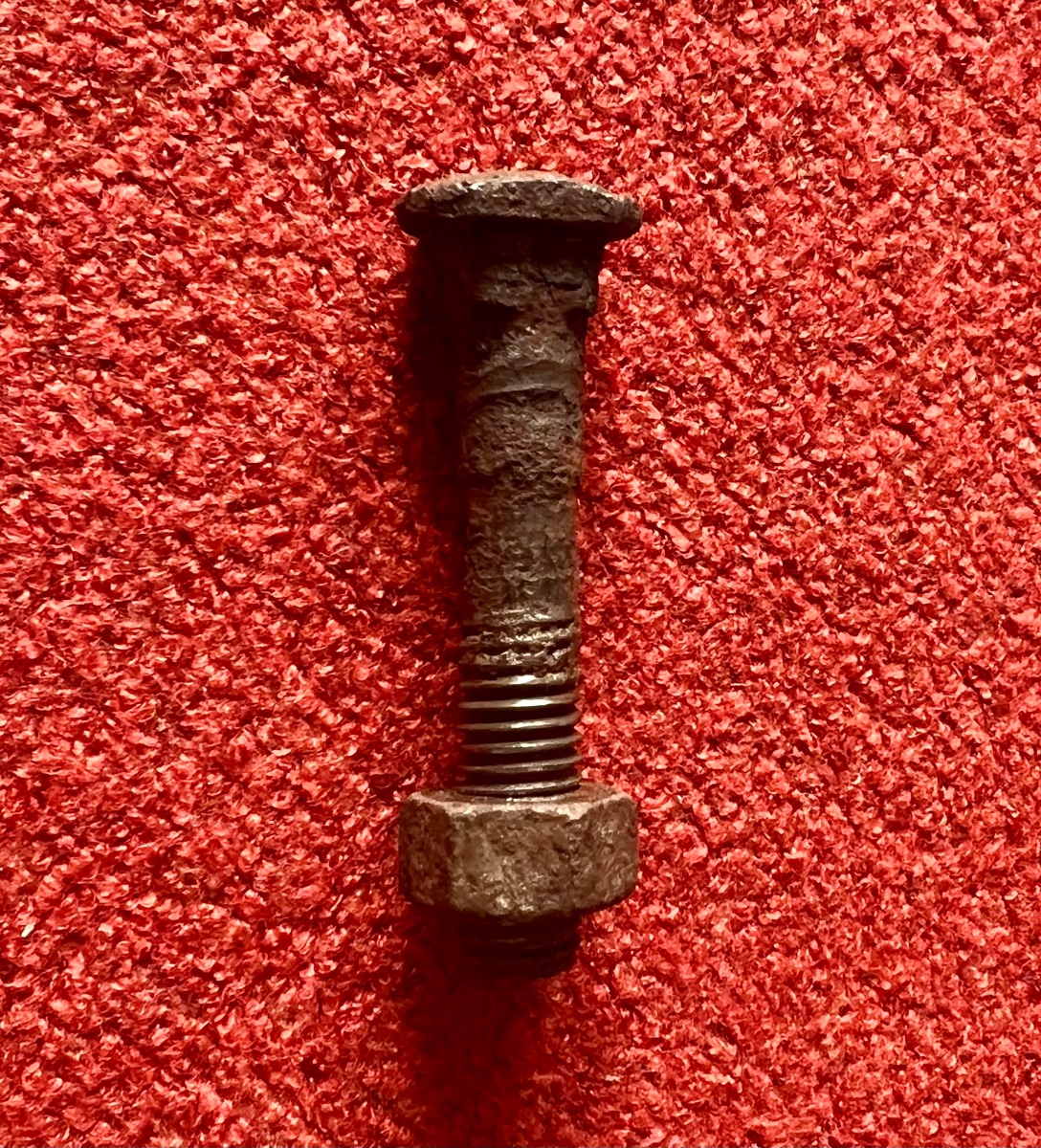

I gave the bike a decent clean yesterday, stripping off a few fairing panels and the silencer so I could get at some of the winter crud.
I am fairly fastidious about keeping it clean and greased up, so I was rather surprised by the state of the exhaust clamp bolt. It came undone OK, but looked horrible!
Hence a quick online search took me to a stainless steel equivalent stocked by Motorworks.
Ordered and fitted, hopefully it’ll last fare better than the original. Considering that it’s ideally placed to collect the worst conditions you’d think that BMW may provide something more suitable as OEM?
