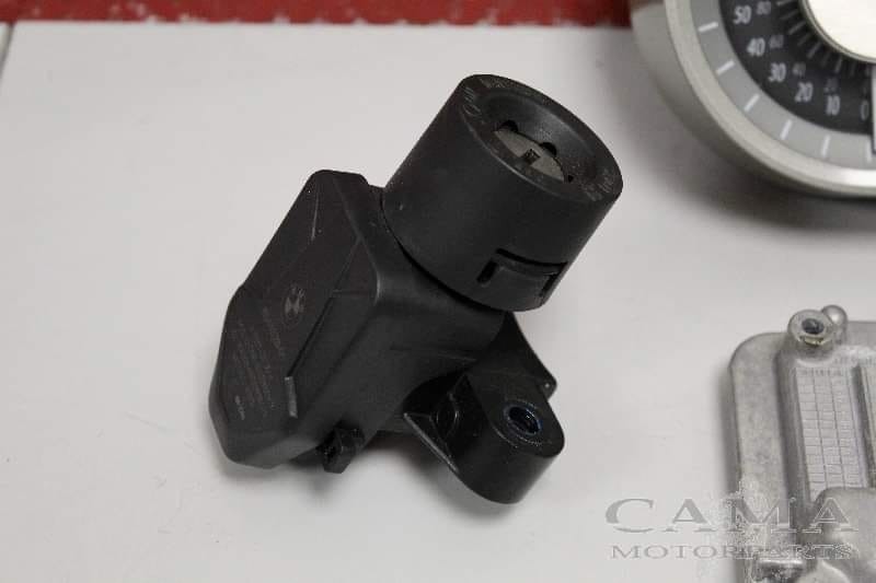

Please, look this video at 4:00 minutes... The ignition is out of BMW S1000 but its exactly identical to mine... and at minute 4:00 the guy disassembled the unit/module... From what i can see, i do have a ring antenna on my ignition... what you guys think?
a little background: When i arrived in Florida, i had a problem with my left combined handlebar switch (the one that controls menu etc..) so, i removed it and tried to clean the buttons... i actually managed to damaged the circuit board inside the switch... so i ordered one out off ebay to get delivered on my house in New Jersey... after messing with that left handlebar i noticed that sometimes my alarm was acting up... (so in my mind the bike was noticing the Menu button was damaged...
i made the whole trip back to NJ within 20 hours not being able to mess with my menu feature due to the damage i've caused to my combined switch Back to NJ i parked the bike and right in the next day the yellow key showed up... 2 days later my new combined switch was delivered and i replaced it thinking that would solve the issue... I was wrong... it still have the yellow key...
So, putting the puzzle together, i remember, back in florida, washing the bike with the key inserted in the ignition... and i rode during rain and differents weather in Florida... i'm thinking it might be something related to moisture...
i've attached one picture with the exactly same ignition as my bike.

Tche_Gradiente wrote: Sun Feb 26, 2023 11:17 amThe ignition is out of BMW S1000 but its exactly identical to mine.
Looks the same as this one from Bob's BMW, https://www.bobsbmw.com/store/product/i ... s--r1200gs
Not the same part # as that for an RT.

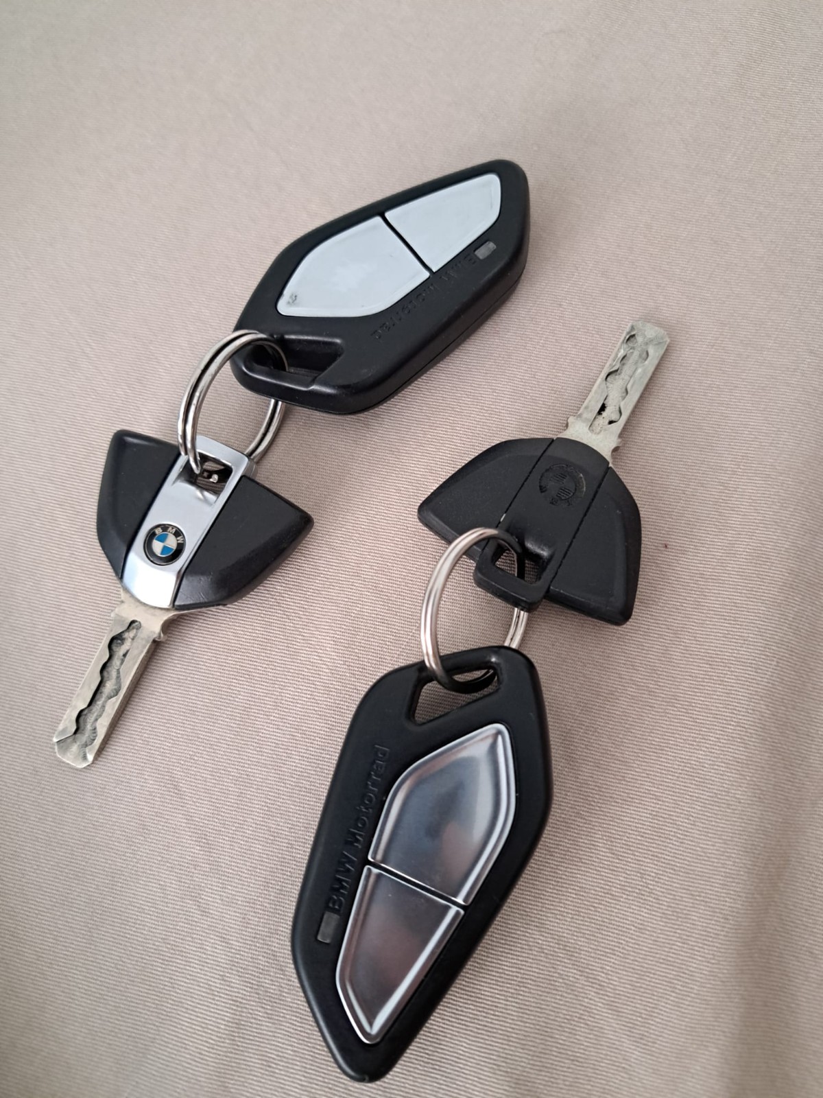

Guys, just an update...
Coincidence or not..? So, i removed my upper tree brace to take a closer look of the security bolts... started drilling them, and gave up... next day i read in a different forum, the guy suggested to take my fobs away from the keys and try to start the bike... I tried that and it didn't work.. same issue... let the bike sit for another few days... and in meantime i ordered a ignition key switch/module... i still convinced its some sort of damage to my ignition lock switch integrated ring antenna...
So... today, few minutes ago i was on a face call and went to show to my friend what was showing on my instrument cluster.. so, i got the key that has been left alone, single, without the alarm FOB attached to it and put in the ignition..
Guess what happened!!! The stubborn came back to life! Like, literally out of the blue! i pressed the start button not expecting anything and she... Vrrrooommm.. i was like :shock: :o i even hang up on my friend! lol
And i started it another few times.. like nothing ever happened! And now i have a used part coming from Europe!!
Idk what to do, because i do long trips (you guys can tell by my "117k miles on the clock") and i don't want to get stranded middle of nowhere , but cant trust to take it for a long ride anymore!
I just checked the second key and it did started normally... probably was just coincidence removing the fob from the keys...most likely moisture that was in the ignition lock ring antenna circuit board and probably is gone by now..
I'm so happy she is back! Tomorrow will take for a ride and only turn it off when i get back home! lol

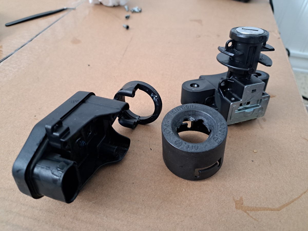

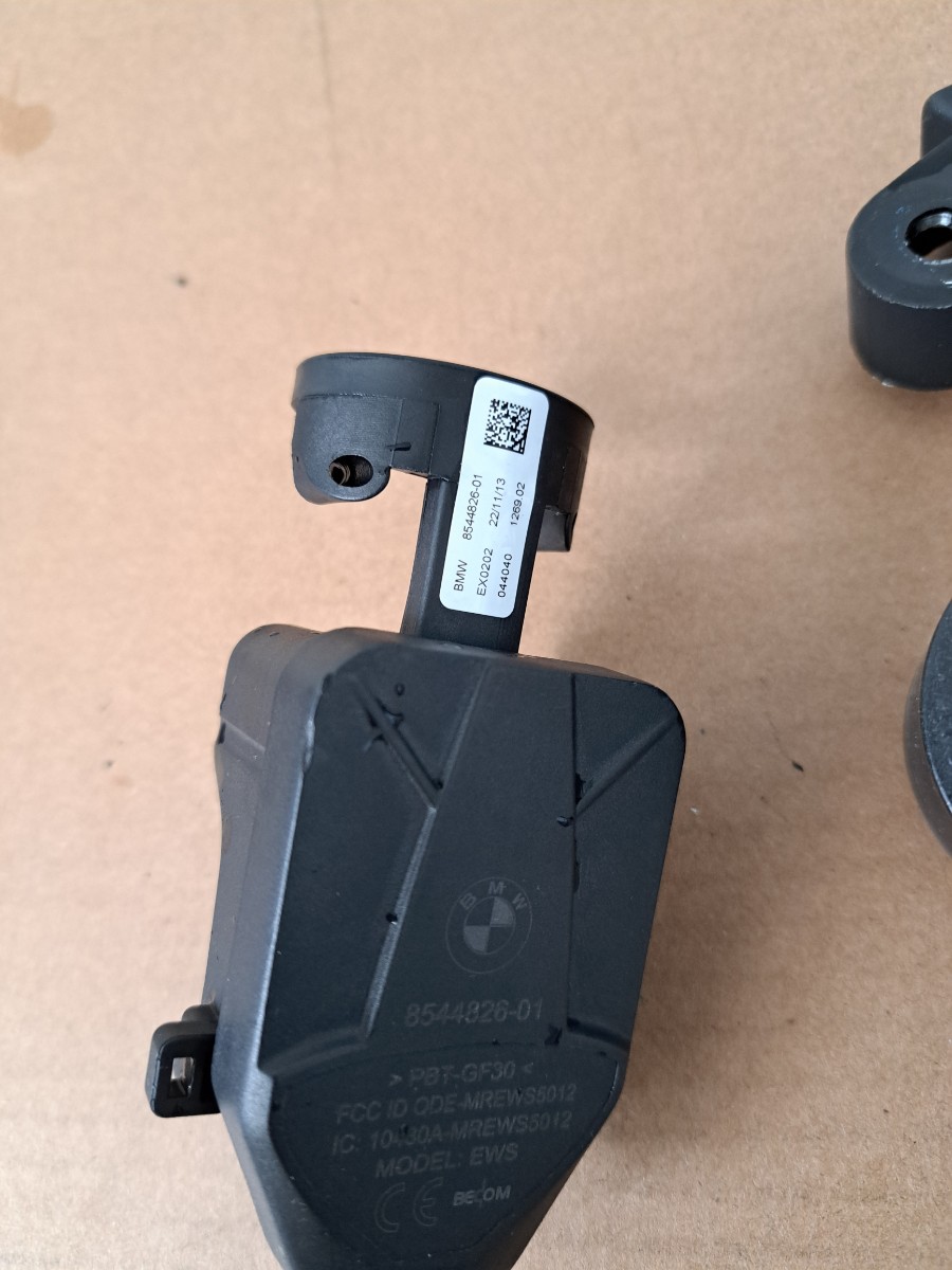

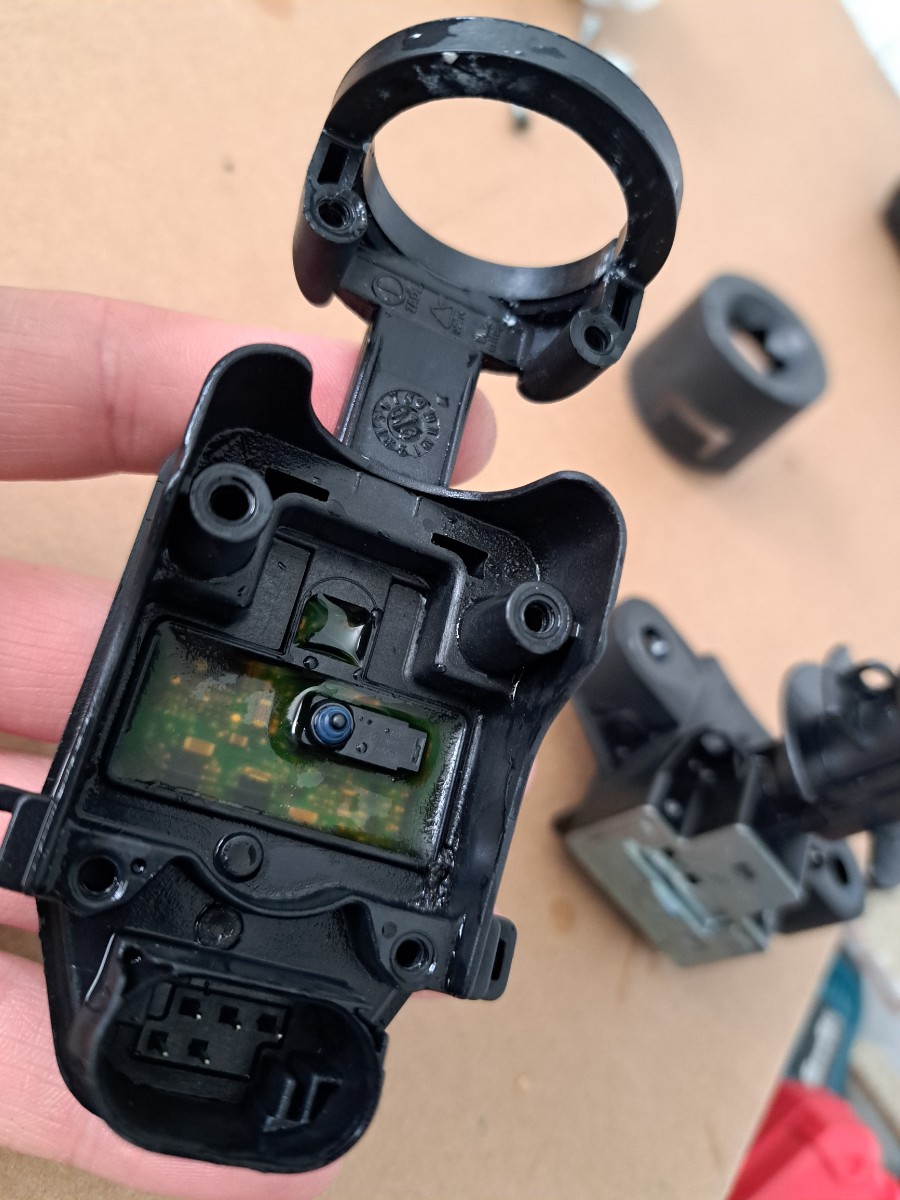

The issue came back, i removed the whole ignition lock switch, cleaned really good, hit it with a heat gun carefully, cleaned the connector...
Problem solved. How can I close the thread?

Thanks for updating this @Tche_Gradiente
The video I have seen of facebook makes interesting viewing too
I wasn't aware there was a pin that came out the ignition switch and pressed a button in the antenna
I am wondering if its a defective switch or something like that
