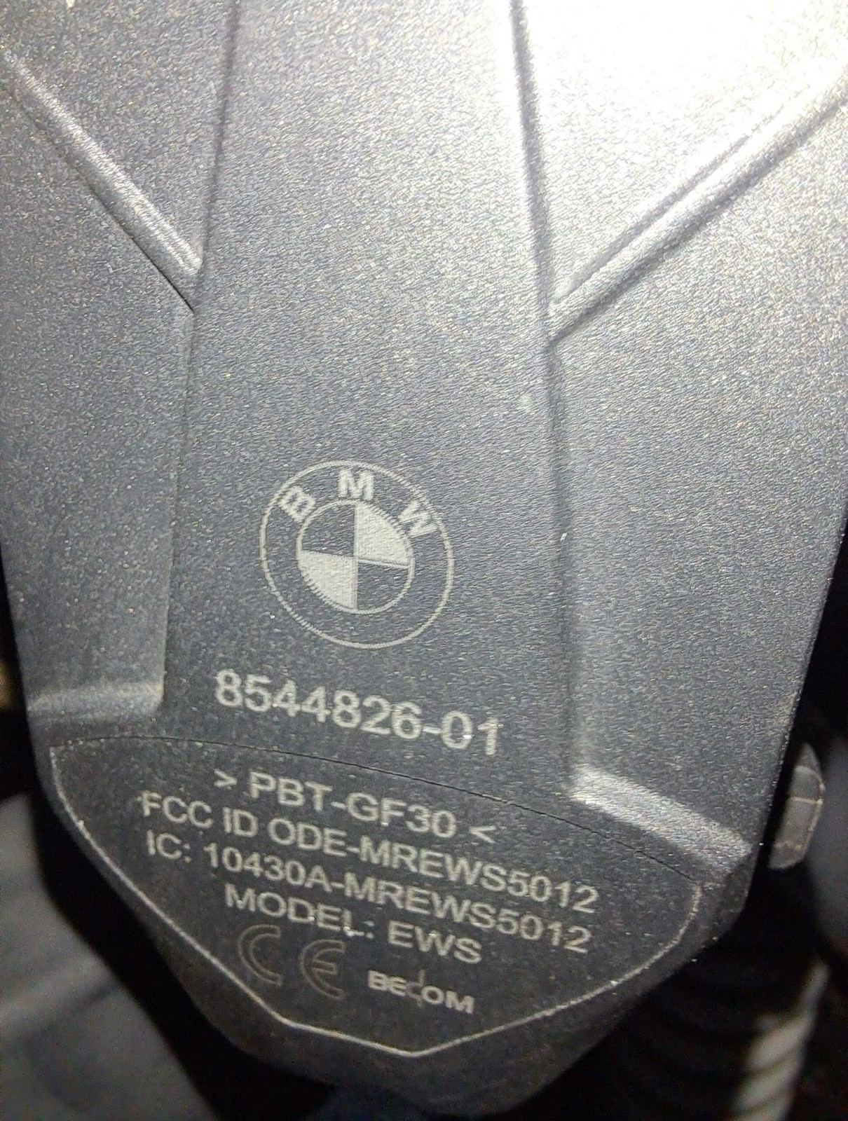

Next day i went to move the bike around and when i inserted the key on ignition, it showed a YELLOW key SYMBOL displayed on the instrument cluster and bike wont even try to crank... Everything works, like sound system, onboard computer... but bike wont start.. i know the Oil cooled RT had the ring antenna problems, but from what i researched on internet, i don't see any ring antenna for EWS beside the module right underneath the ignition.
I've connected the MOTOSCAN to it and there is a stored code (CD9436 CAN message(from electronic immobiliser).. after a lot research on internet, only thing i was able to find is, the code is related to the EWS not being able to read the key on ignition... i tried my spare key.. nothing... i dont have the emergency key...
Please, any idea? do i need to drill the secure bolts and replace the whole ignition module?

You guys are amazing! i've been digging the whole internet for days and couldn't find anything related to the 2014 one only the old antenna ring from 2000 Rts. Thank you so much for the insight!
I was about to start drilling the bolts (security) that holds the ignition key switch to the upper tree...
By the way... my 2014 RT doesn't have the keyless ride, mine is the traditional key with alarm... so, does the antena ring still in the same place (behind the instrument cluster) or is mine integrated with the ignition switch? Basically mine doesnt have the keyless button, it has regular key instead and it has a lil module attached to the ignition... and i dont see the regular ring antenna like i see on previews RTs...

Good point about the keyless ride! that could change things and @David. could be right and that its in the ignition switch
Before you start drilling you could remove the cover above the clocks that houses the sat nav and you can see if you have the antenna ring on the back of the clocks

i will definitely check that tomorrow... i have the suspicious that mine is integrated with the ignition... Thanks again!

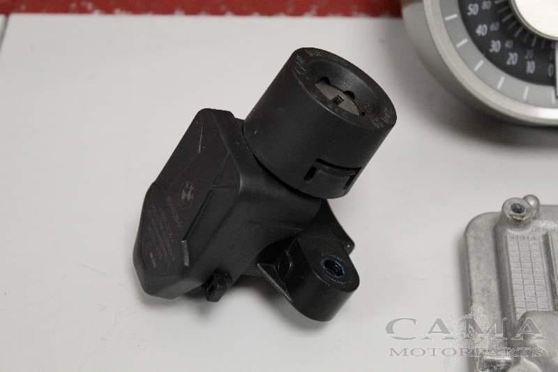

Could this be the ring antenna on the back of the clocks for keyless ride.

From what I can see there is 3 different types of key configuration!
keyed ignition
Keyless ride
And Keyless ride with RF remote control locking system
Everything I have read always suggests to put the emergency just above the clocks to start the bike in an emergency as thats close the the antenna

I think the only way to know is for someone without keyless ride and central locking to have a look to see if the ring is fitted
Or maybe the keyless ride has to be coded to the antenna?

Of the 3, could this be the one on the RT in question, the other 2 are keyless.
